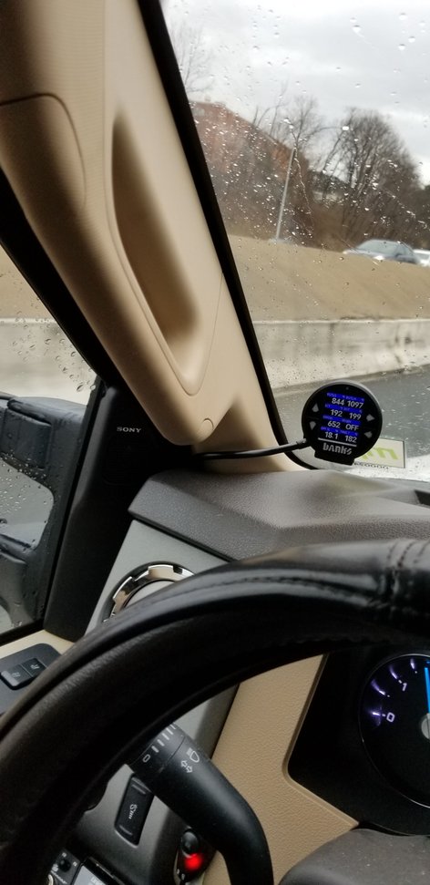

depending upon your use and driving habits. Yes the interval will change with each regen. Mine today (I have a 2013) was 652 miles. But ford advertises a mandatory regen at the 500 miles mark for EPA rules.
Biggest thing that effects the emissions is extended idleing or low speed stop and go.
Diesels are most efficient when working.

I am using the idash

The cord that you see comes from the idash and goes directly to the obd2 plug in. The idash takes the reading directly from there.
