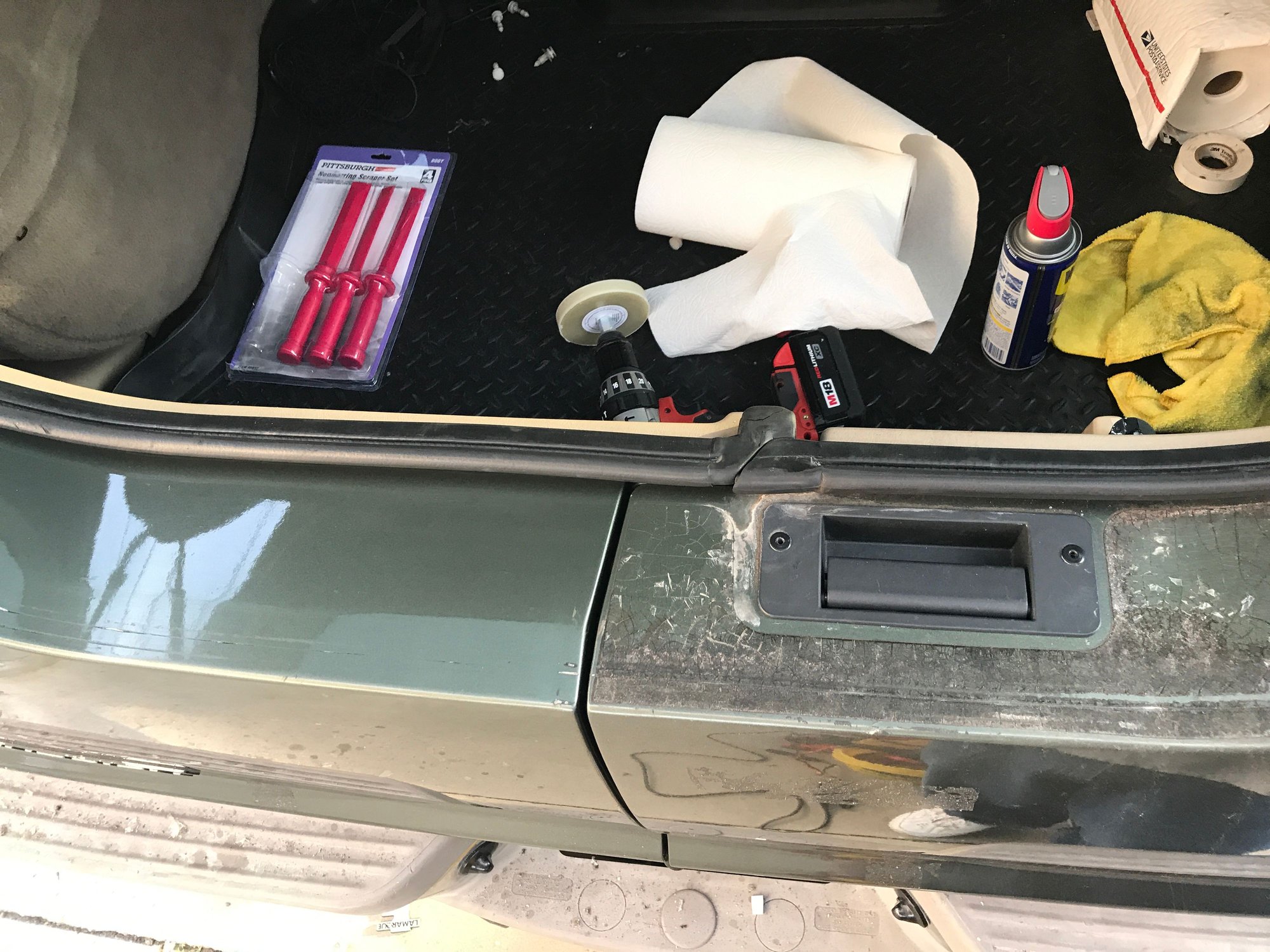

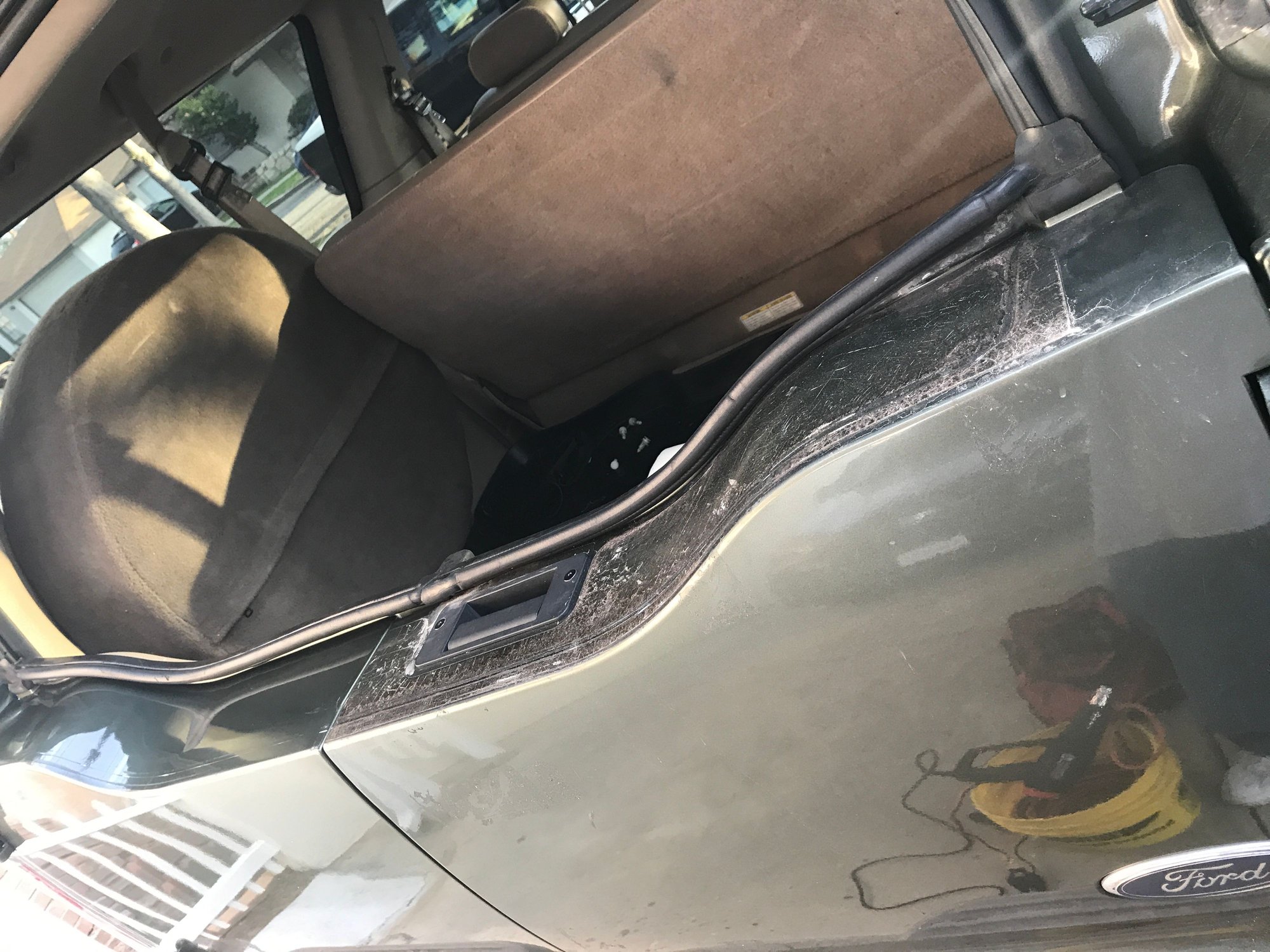

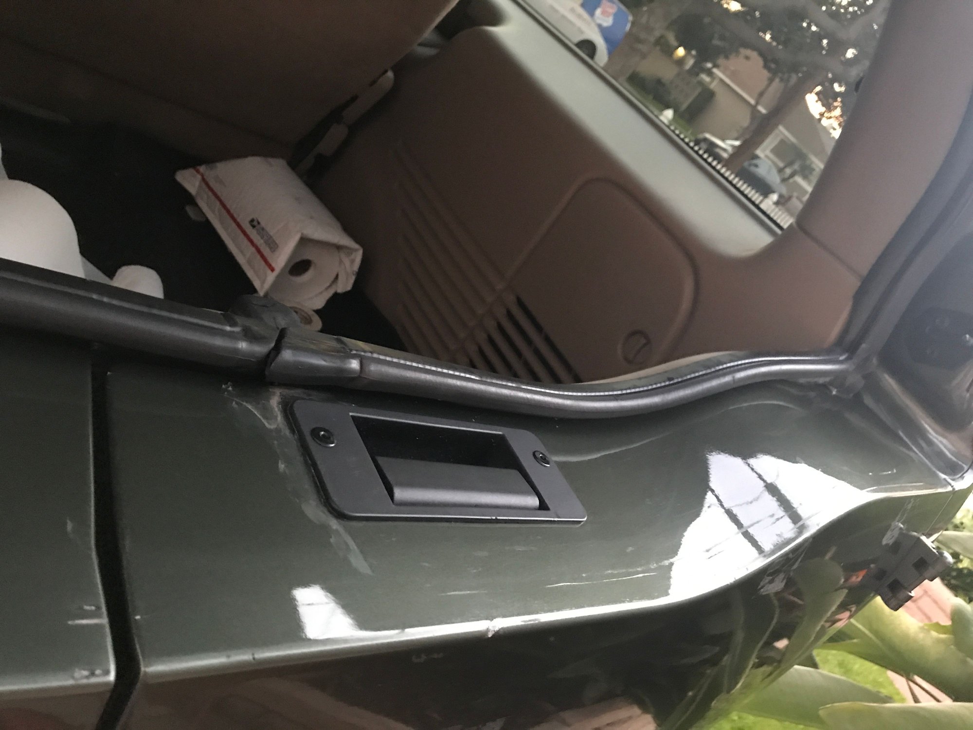

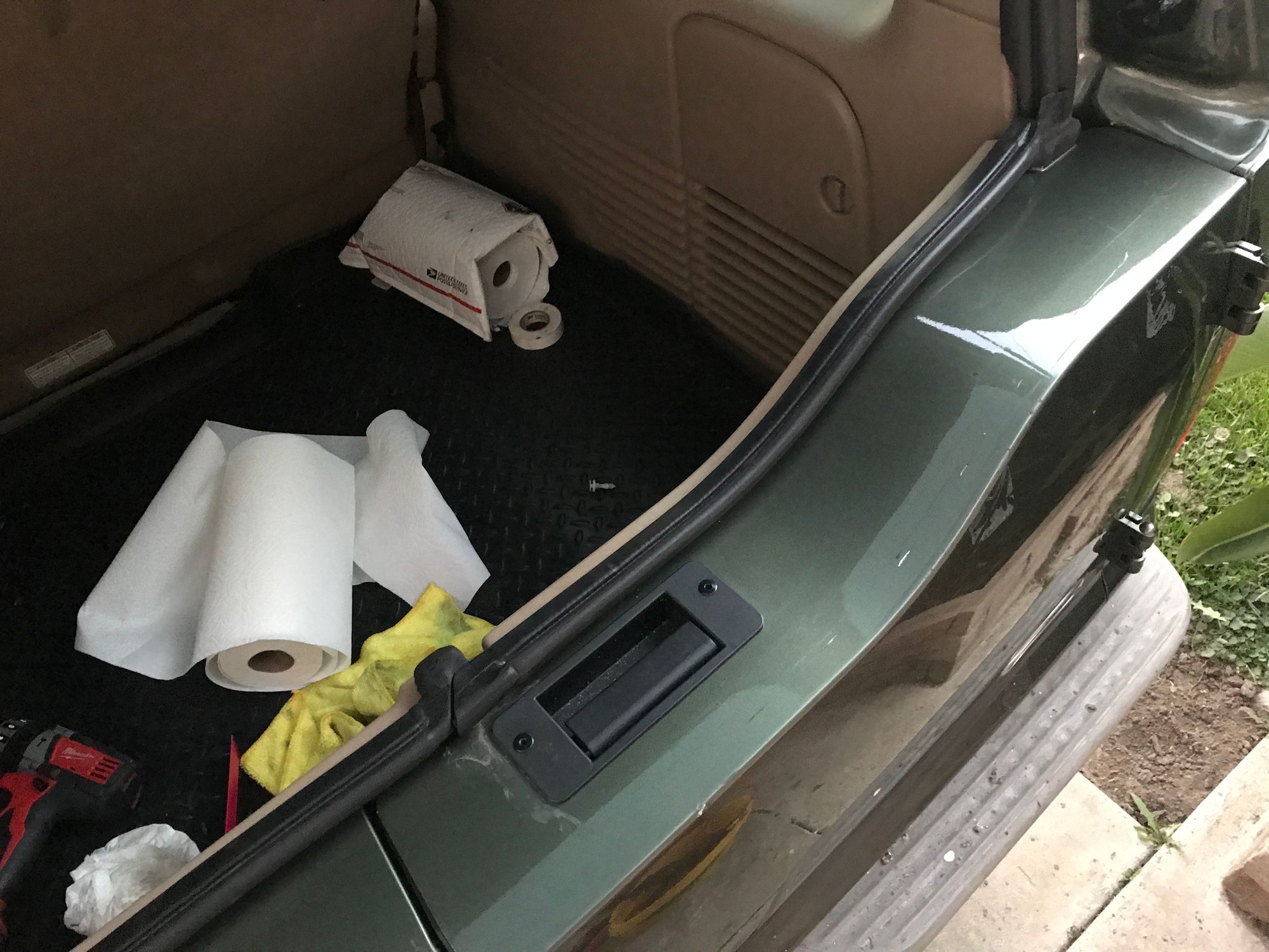

Romoved that ugly vinyl!

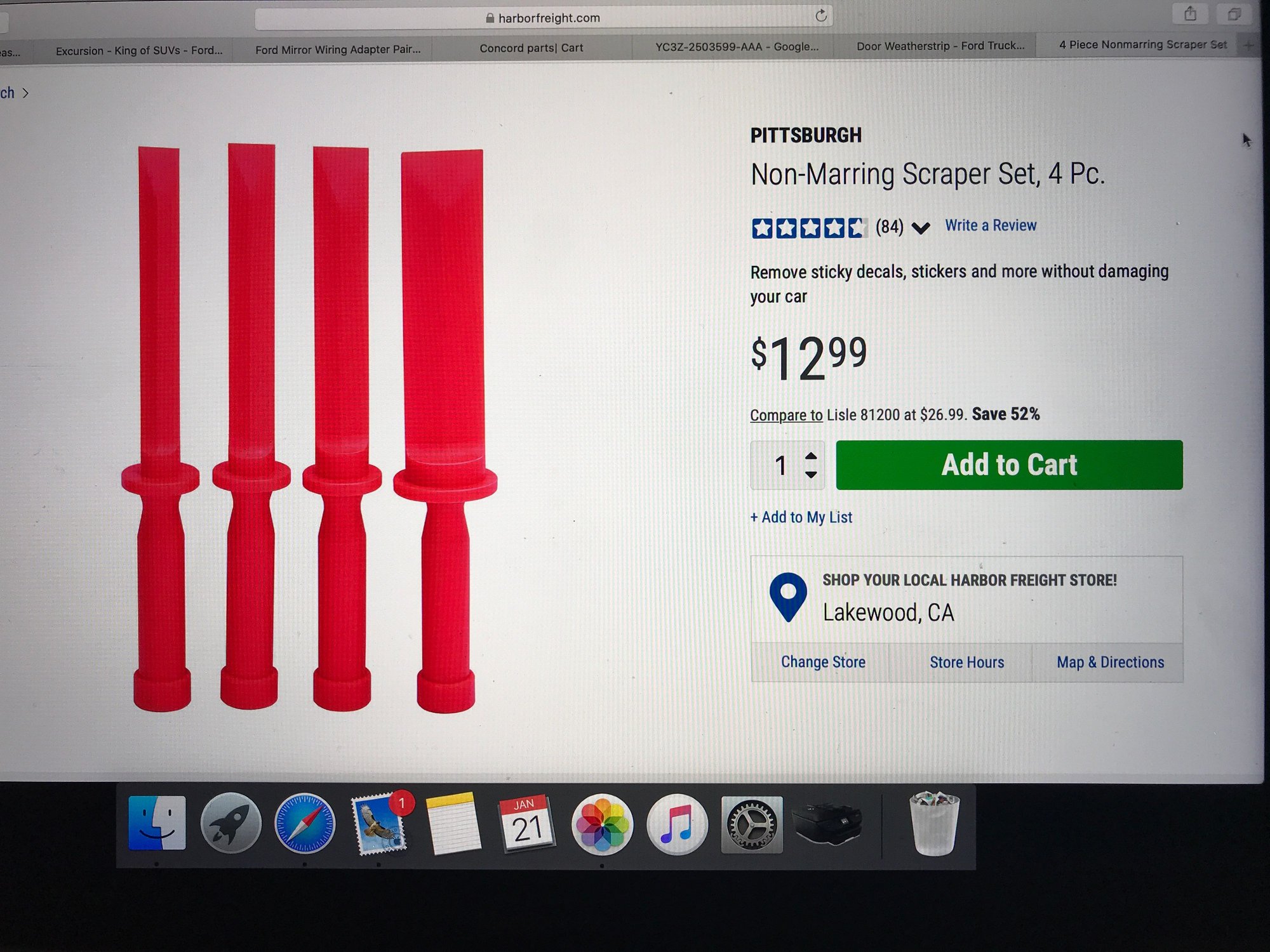

Today I went to Harbor Freight and picked up some of those plastic chisels, some WD-40, and started to work. First I tried the heat gun and it seemed to work but only sort of. Then I tried WD-40 to see if it would eat into the vinyl but it's effect was minimal to worthless. Then I broke out the 3M Eraser. The 3M Eraser seems to work pretty good until I got a butt load of mess for such a little area. Back to the heat gun, and it worked very well once I got the hang of it. The trick was to get it hot enough but not burn the paint, and do small areas at a time. This job took me about 4 hours of careful heating, scraping and hand polishing with swirl remover.
Did I mention these barn doors came from a different truck? Yes mine had glass damage so I found these at a bone yard and swapped them in. I got lucky as they were the same paint code eliminating the need to repaint. I have so far $500 invested in new doors and supplies as opposed to a bodyshop quoted me $1500 to fix the glass and repaint. Savings + $1000.00
Thank you to those who provided the ideas of the plastic scrapers and the 3M Eraser wheel including Mr 01_Excursion,
To finish it off, I think I'll put some black vinyl so it covers the whole top of the barn doors hiding the imperfections from the past 20 years. Anyone have a better idea?

Wow, that turned out nice, I'll remember to post a pic of my doors and the chaffing caused by the newer style mini center gasket instead of the long one. I actually need filler on my doors, I have already adjusted the black handle trim on the glass when I put a new one on. I too want to remove the 3M film, but thought about going with a hyper thin sculpted stainless overlay to prevent wear to the doors again.
