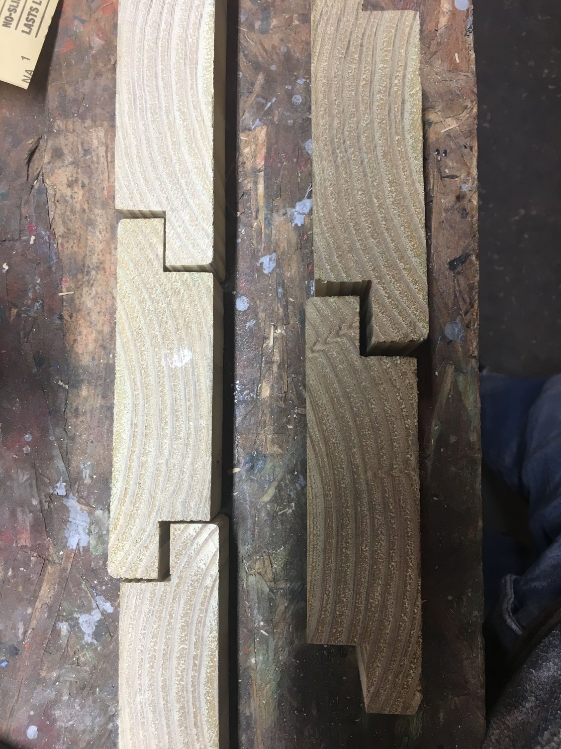

Thinking about the truck bed for my 53 F500. Not sure weather to use 2x8 or 2x10. Not using pressure treated lumber just plain southern yellow pine, scorched with a torch and then coated with a mix of motor oil and transmission fluid. (I’ve seen some done like this and I really like the look)
Will be cutting ship lap notches in each board, not sure weather I want a T or a Z style. Z would give me all same size board widths. T style would give alternating short/ long widths. I have a photo of some wood I cut using the different styles. these were just scraps that I cut to get an idea. These were just 2x6 but the idea would be the same weather I decide on 8s or 10s. Bed width is 84” plus side rails of 3/4” and posts of 1.5” for a total width of 88.5 witch is slightly larger than the width of the rear tires.
What do do you guys think?

I cannot condone the use of the motor oil mix for obvious reasons, plus if it is going to be exposed to the weather it will constantly have to be retreated because rain will wash it away (oil being lighter than water).
Either way you lap the joints in the decking is going to result in cracking and splintering as the wood dries and is subject to movement, imo. If you want a perfectly smooth deck, I would suggest 1" T&G plywood. Pine is a pretty soft wood too and can't take a lot of abuse. My first choice for slatted decking would be Apitong.

Mixerman, thanks for the info above. I know I want boards of some sort instead of plywood. 95% of the time, the truck will be sitting inside. Do I need to have ship lap? As far as I can tell, the truck did not originally have overlapping boards but they were 1.5" thick. Maybe just lay boards side by side and see the cracks. If so, I think I would just go with the 1" thick red oak that would match the sides. Maybe I should just go with pressure treated and paint it black after it dries in a few months. The plan is to use lag bolts and angle iron to attach bed boards to cross members from the under side so no bolt heads show. Too Many options!

Truck or trailer decks have never used overlapping seams for the reasons stated previously, plus it would make them very tedious to replace should it become necessary. Imo, you need to rethink the underside lag bolt fastening, that just isn't done for obvious reasons - the vehicles following you will thank you for it. If you don't want screw/bolt heads showing just counterbore the holes and wood plug them like the deck of a fine yacht. I've done this many times and it works very well, and holds up to the elements.

Put boards side by side. Rabbit the edges and put skid strips between each board like the pickups do. Mar-K sells stops in any length. Go to Mar-K.com to see what they have.

I would just butt the boards together. The smaller the boards the less you will see expansion and contraction. Ship lapping the boards creates a weak spot in the wood. It will also trap water, moisture, dirt, etc. As for oil and tranny fluid on the wood, that sounds like and environmental issue to me. Where will you keep the truck? It is going to smell for sure. And anything you put in the back will get oil on it. Not sure that is a good idea. Pressure treated wood and steel don't get along well. It promotes rusting. Now that I have cut you down enough, if it was my truck, depending on the use 1" hardwood would work good. Depending on the use will guide the type of finish if any you put on it. Pine is good as well, just softer.
