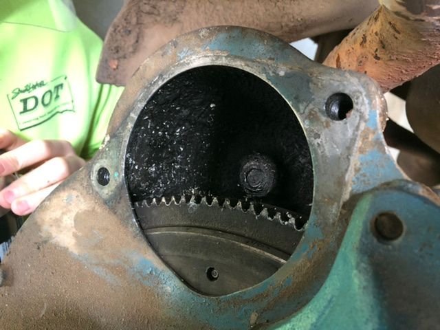

We have replaced the battery cables and are going to replace the cable from solenoid to starter. Pulled the starter and found this:
pretty sure this is not optimal.
Explains why it cranks for a few turns and then stops.
any thoughts?

Is there a shim for this? Do I need a bracket to hold the front end?

Thunderkiss1965's Avatar
Thunderkiss1965
Joined: Jun 2019
Posts: 1,899
Likes: 236
From: Southern California
The plate between the engine and trans bell is the only shim. If there is supposed to be a bracket I have seen enough missing that I don't see that being your problem. My money is on a pos reman starter. Swap it out under warranty.
