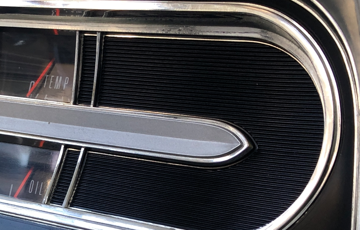

I tool my dash bezel out to send it in to get rechromed and painted. Then noticed a very small crack on it along the top edge that I did not notice before. Looks like it was overtightened at some point, or just gave out due to tension. Now I'm looking for a replacement.
If anyone has one, I'd definitely interested. One that otherwise looks perfect. The trick is the bezel seems to be very specific to 1967 and so it is a bit more challenging to find. It fits the same as others, looks almost the same, but is not. On the left and right where the black is, it has horizontal lines. The others are plain flat in that area.
You can actually get brand new bezels, but not with the horizontal lines. While this fits the 1967, it is not the same. I'll buy you one of these and throw in extra, if you send me your bezel without cracks!
https://www.dennis-carpenter.com/en/...luster-bezel--
Here are the places where I'm considering sending it once I find one that is not craked. It requires a very specific method for stripping and rechroming. But from what I'm reading, this can be successful and some of their photos of completed projects look very good. Because I look at the dask bezel everytime I get into the truck, I'd like it to look as nice as everything else. If not nicer. I'm going to do this with the radio bezel as well.

Here are photos of my existing bezel. Not bad. But you can see the chrome flaking off.

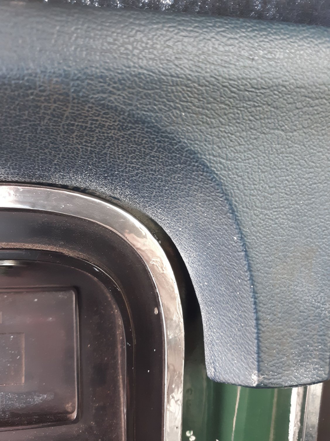

So tested a small spot on drivers side bezel with the 2mm pen, and it is totally gonna work out. The chrome really flows out fast, and find it best to just hover the tip over the surface and let it flow onto the work. It seems to self level pretty good, but found it's best to get full coverage in the wettest spot before moving on. Going back to fill a thin spot you just went over gets slightly wavy. Not sure how durable this will be over time, but guess I am gonna find out. More pics once I do the whole thing
Pass side factory chrome
Drivers side with molotow 2mm pen
