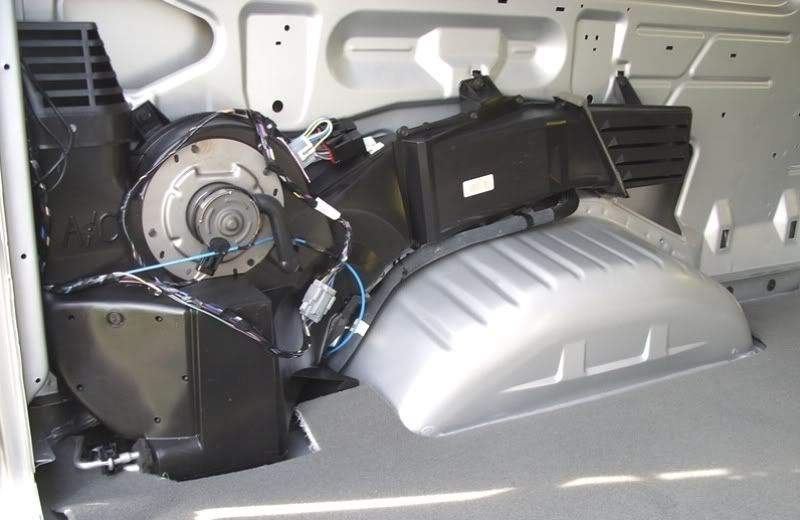

That's a bit different from the '92 and later E-Series where the evaporator and fan are behind the left/drivers side rear wheel. That configuration looks like this:
Heater core towards the front of this case, evaporator bottom rear. Full Club Wagon trim includes overhead headiner air outlets, floor mounted heat registers. Function and air flow is determined by the Function Control on the dash board--through the ceiling vents for A/C, floor flow for heat. Neither temperature can be modulated like in the front systems--fan speed sets the rear relative comfort level.
