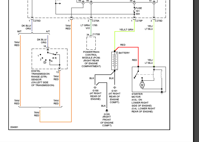

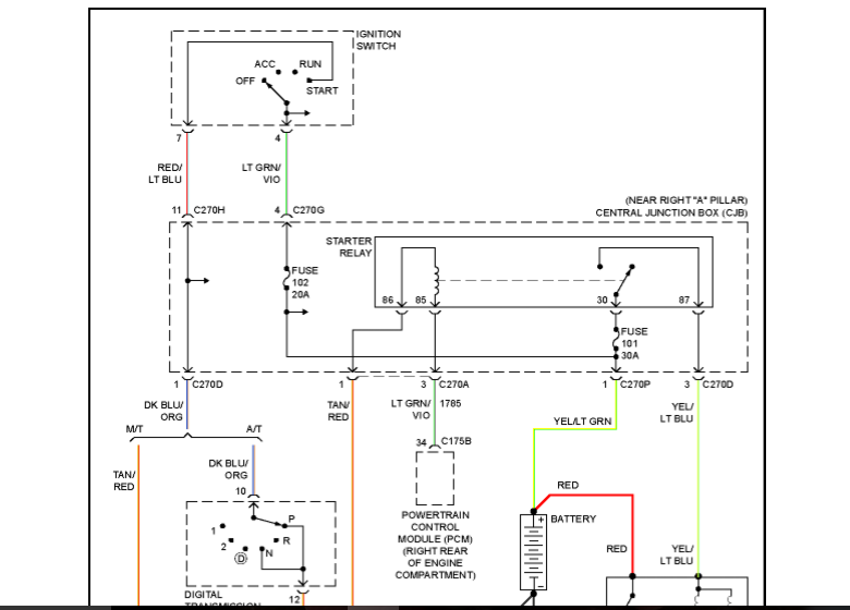

Not that I no my b--- from a hole in the grd . I don't see a failure of the pcm . The start relay must receive a grd signal to get it to pu which comes from pcm . The hot side 13vdc position is controlled by shift lever position etc .
Check for good start relay and is 12dc positive getting to relay . The main cause of pcm lack of ground signal is pats system not satisfied '

I realize a lot of what you are saying . I just gave him a diagram to pin point the lack of signal to confirm a diagnosis . We are not there to double check or observe . He can bypass a lack of a signal if he chooses to prove the rest is complete or not . Being a troubleshooter for a large electric company gave me a lot of experience in this as I tried to talk electricians from remote sites thru stuff until I could get there. One of which was a loss of cooling to reactor at a nuke plant ,it came out okay . No I don't think I'm all that .
Just old and experienced still learning -helping if I can .
your diag may be correct . I have not had a lot of exp with a failed pcm in vehicles . I have observed a lot of guys blaming the pcm for everything .
