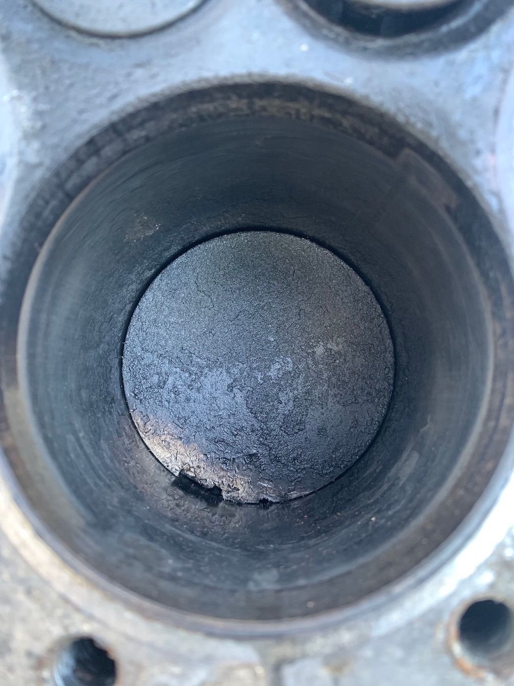

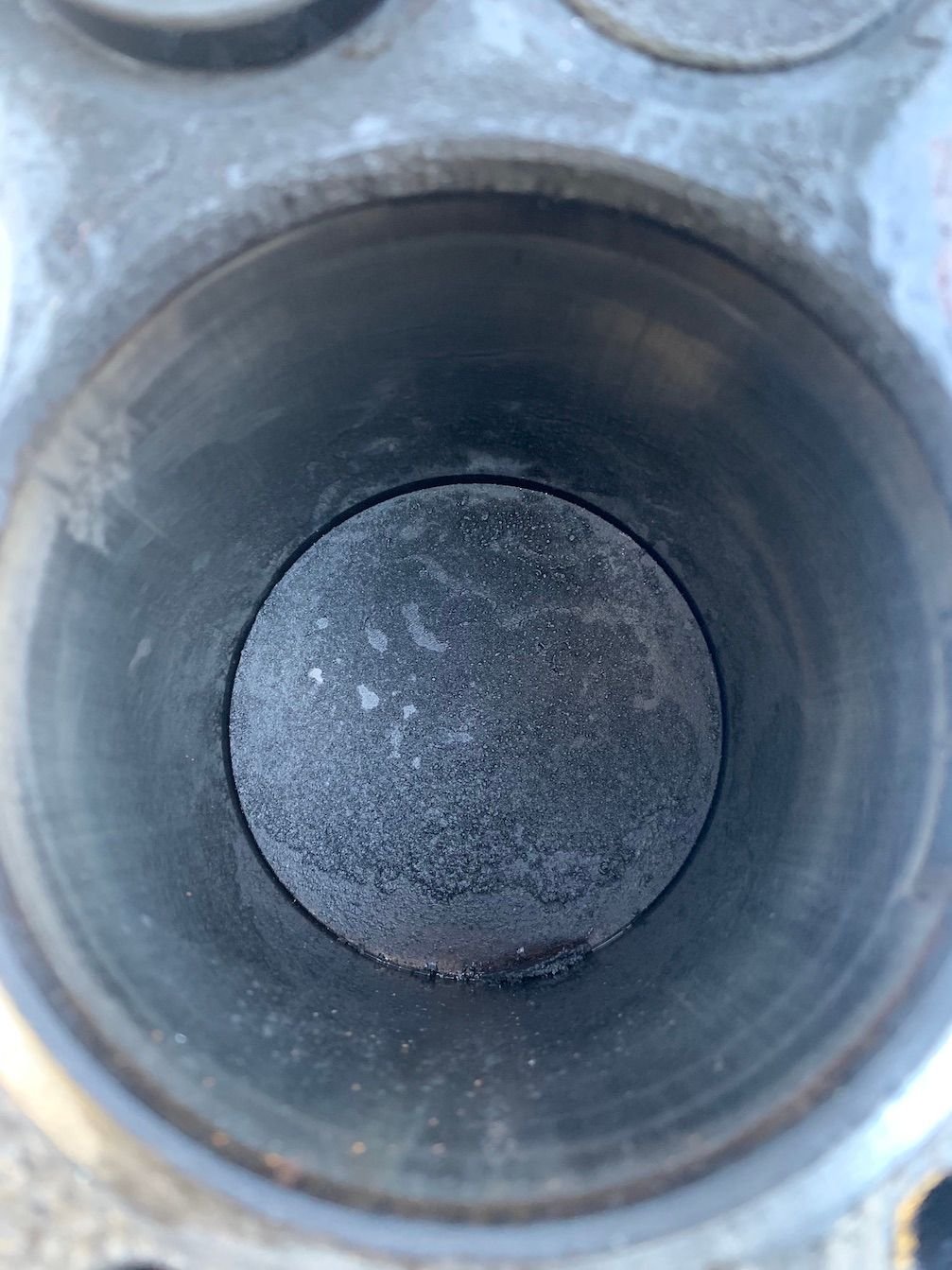

Cylinder walls look pretty good, one piston is bad (missing a small chunk). Carbon deposits plus some intake gasket remnants abound.

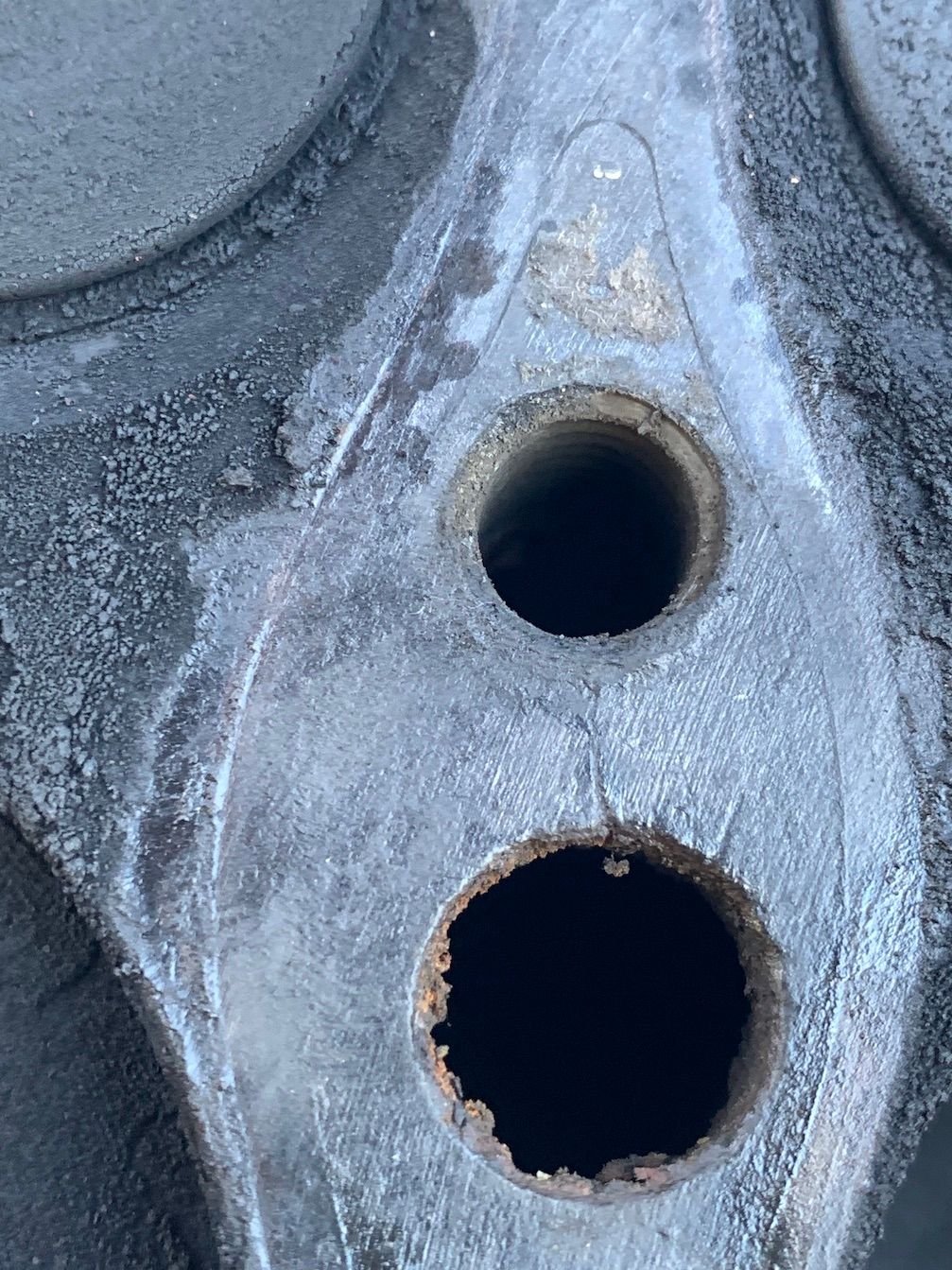

I saw one possible crack, but am not sure (see close-up photos)

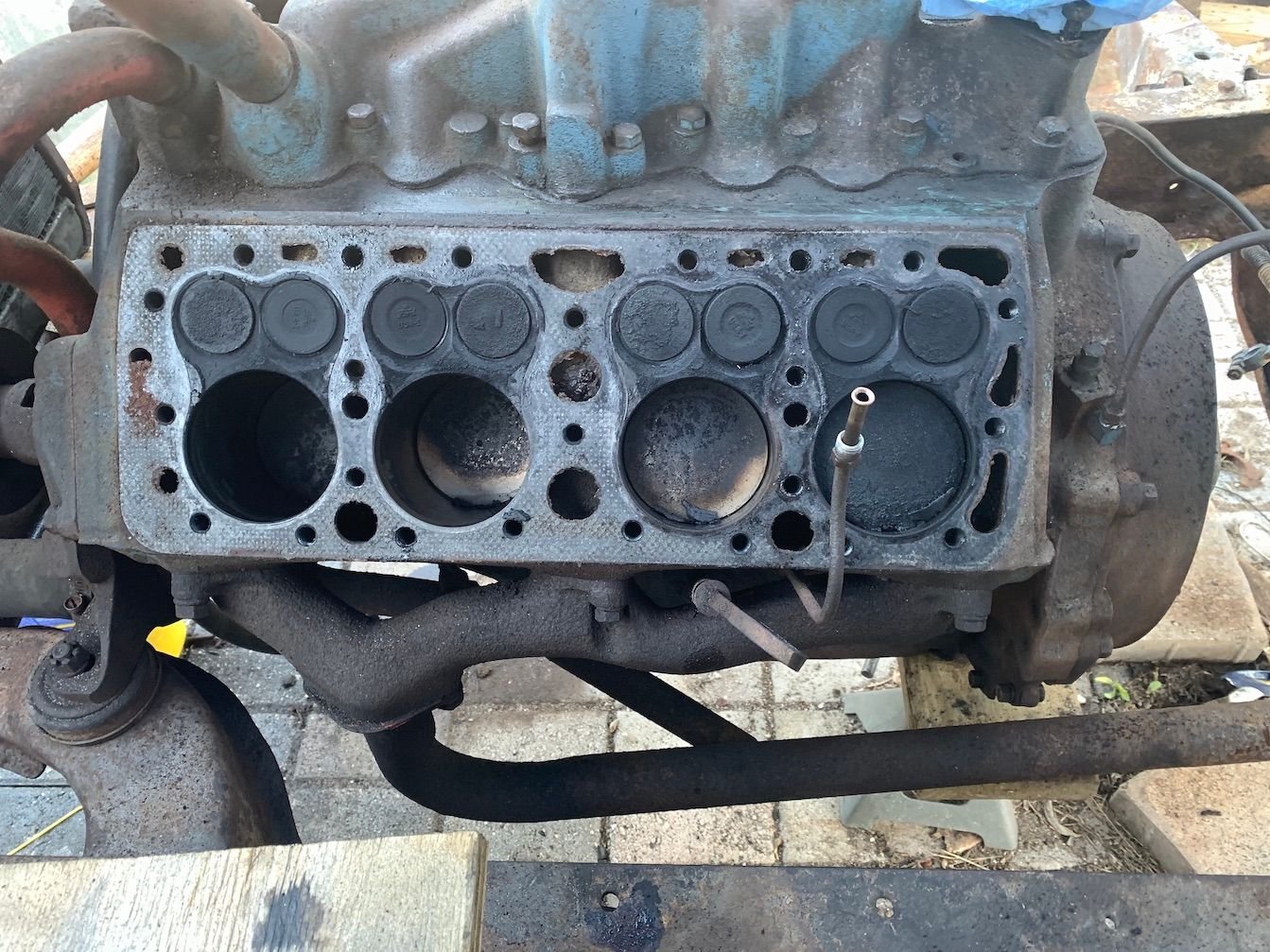

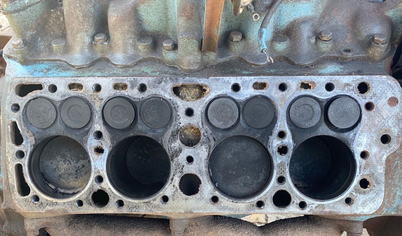

Passenger Side
Driver Side
Maybe a crack?
Hard to tell.
Most Cylinders/pistons look like this
This one is a goner.

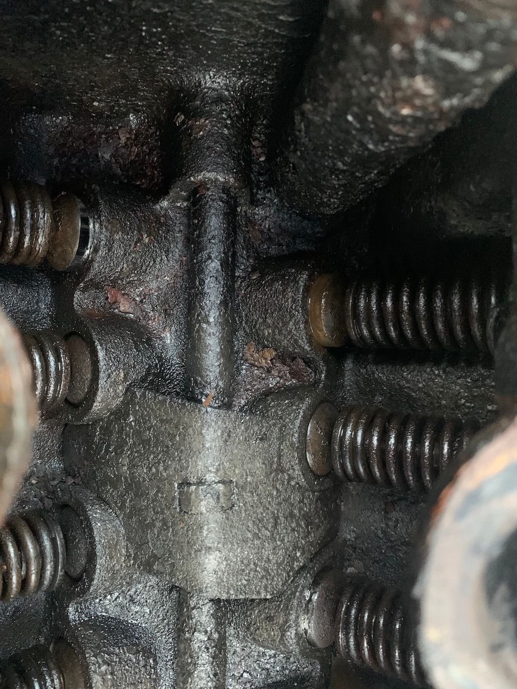

The Valley of Oil Crud
The one lifter peeking out looks shiny.

Passenger side third cylinder back from the front (# 3 cylinder) between exhaust valve and cylinder wall appears to be cracked. Althought its really hard to see in the pictures, you will need to scrape or wire wheel those areas of all carbon build up etc to see any cracks, also look closely in the top portion of the bore in those locations.
ive seen plenty of runner flatheads with those cracks and they seem fine, its just a matter of when will one open up more and or a problem surface?
The one picture of the crack from water jacket hole to head bolt hole is very common and almost every flathead ive seen has that and shouldnt cause any problems.

Depends on your budget. That block looks like it might be a candidate for a rebuild. If there is a crack between a cylinder and a valve it can possibly be pinned. If so, expect the cost of pinning, boring and sleeving the cylinder, and boring and inserting a valve seat.

Josh: I checked the photos (in full res) and the block itself again this morning (how better to start the New Year?).
It is just carbon buildup, the low res photo sort of makes it appear like a crack, but I will put some cleaning time into it over the next week to see what might come up from under the grime.
