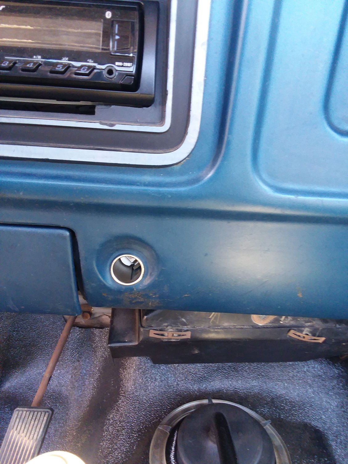

My sons truck did not have a cigarette lighter/power point from the factory, so while I was searching for sockets, I came across this usb charger that also displays the voltage.
I got the socket from Oreilly's and the charger from Wal-Mart.com for a total of about 15.00

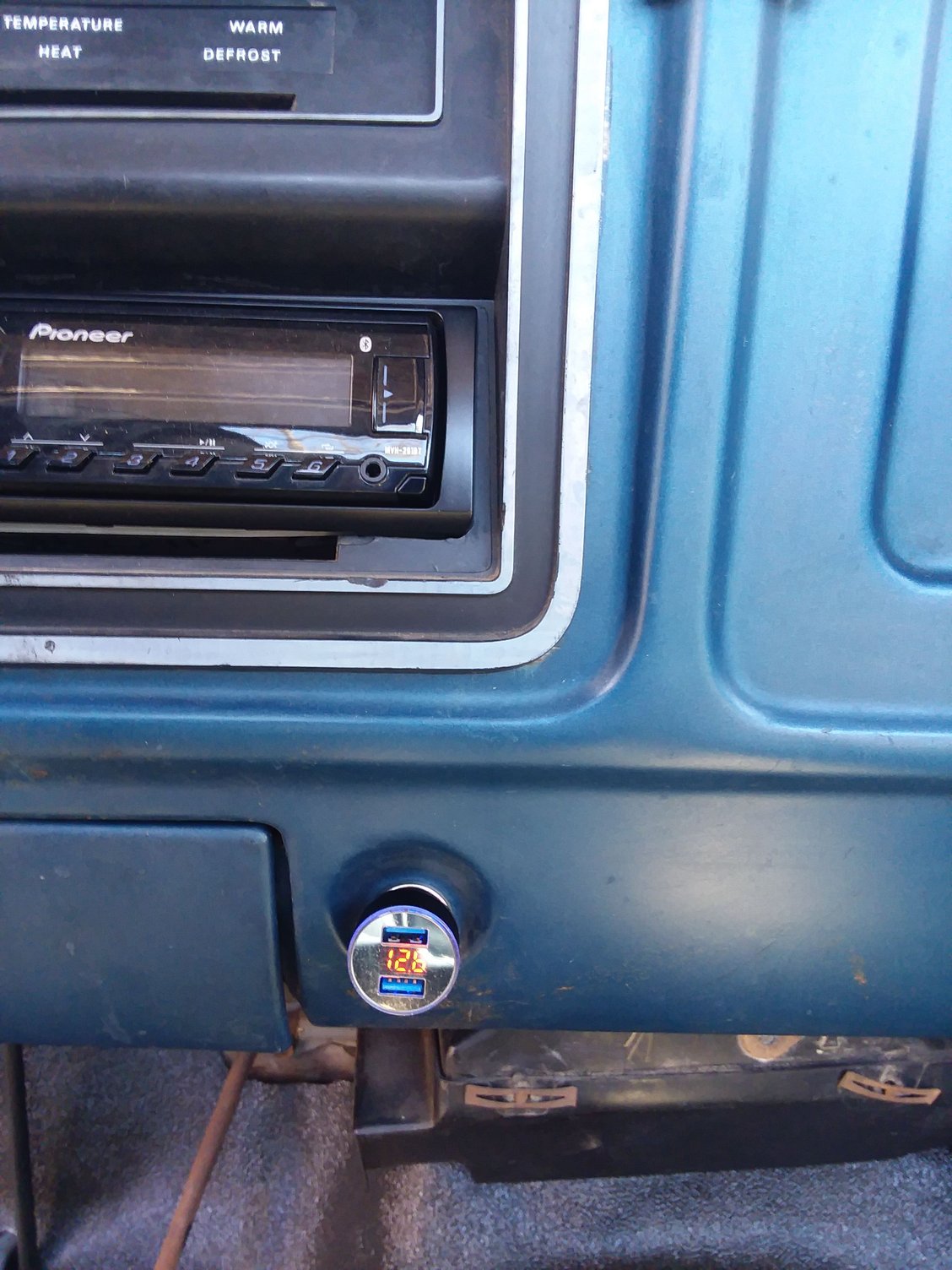

I checked the charger/meter on my 08 and it read correctly with both the key off and engine running.
I installed the socket today. The readings shown are with the key off. We haven't cranked the truck today.
Only downside is it will be a constant draw. Probably won't amount to much unless the truck sits for a week or two.
Reads 12.6 volts

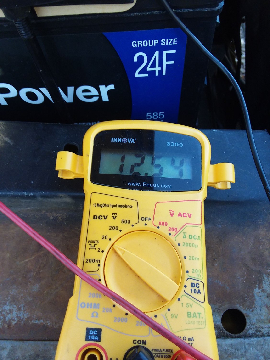

Voltage at battery 12.54 on meter

Yes, I meant when it is plugged in it will be a draw. I wired it into the courtesy light/lighter circuit.
In my daily driver, like most people, I just leave my charger plugged in most of the time,
