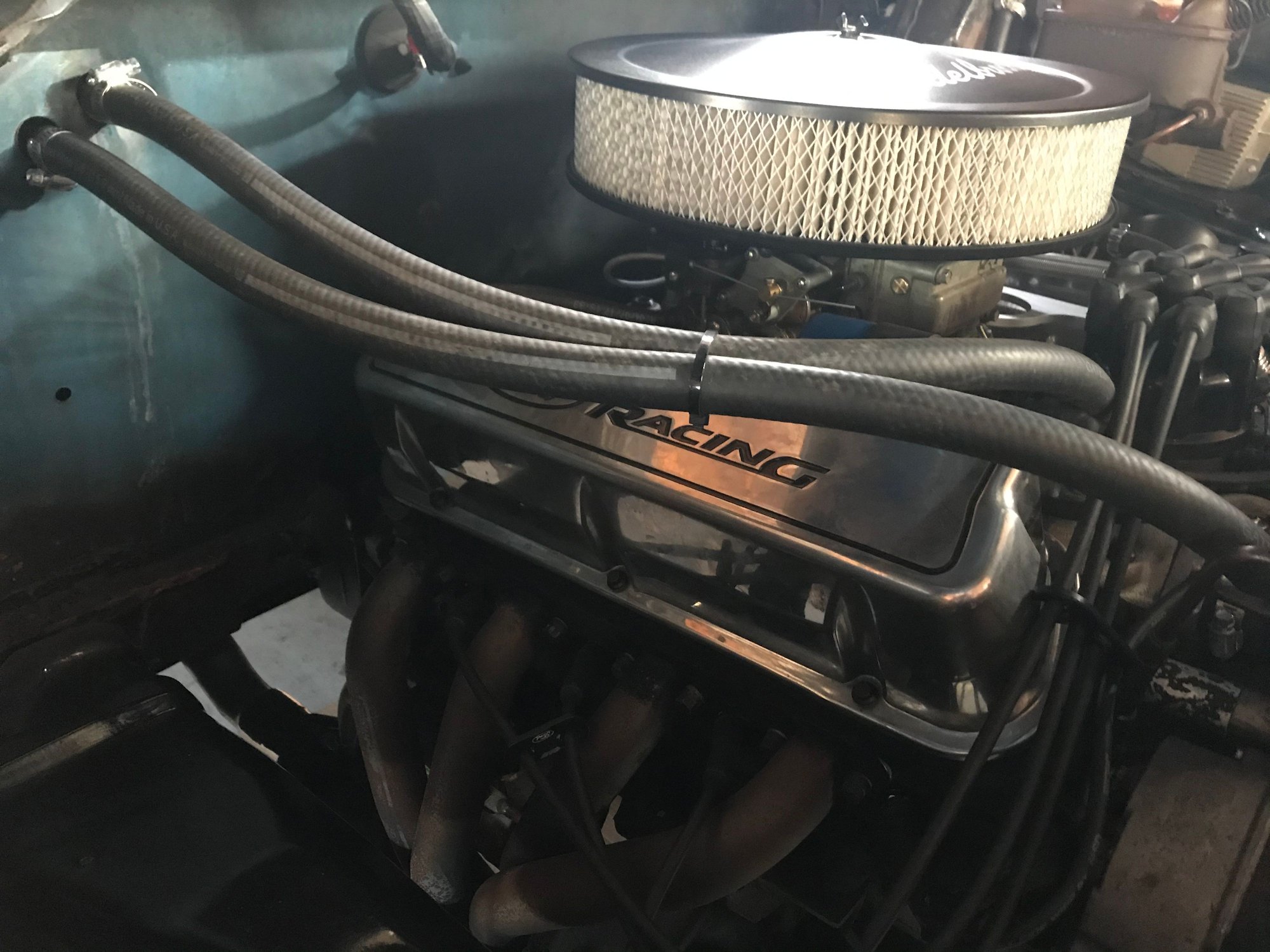

I did already ask some questions on another members thread but felt like I was hijacking his thread so here's the deal. My blower works but the actuators were sticking and with meangreen"s lead I thought and was hoping that was the problem but no it wasn't . I drove the truck and after it came up to operating temperature and was still blowing cold air I opened the hood and felt the two hoses that go into the heater box. They were both hot to the touch all the way to where you plug them into the heater box, this is where the outer hose felt cold. I'm thinking there must be a blockage somewhere inside the box. Question, what should I do?

From: York Pa.
My engine compartment and hoses.
