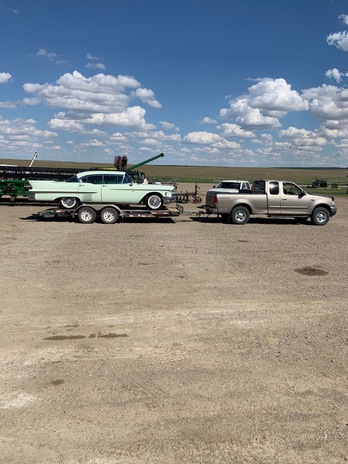

Ok, quick update!😳 Now 2years later, engine runs strong. My high fuel consumption has stopped. I have 219,xxx miles on the pickup now, engine runs very strong but I seem to be losing a fair amount of oil with no leaks and no smoke. I’ve heard other people talk about oil loss with same no visuals. But haven’t heard any fixes. Dose anyone have any ideas as to what might be the cause? I will stay on top of this thread this time. Just a refresher I’ve replaced all at the same time, timing chains/guilds/tensioners, oil pump, injectors, oil change, air filter, water pump and various sensors. I had a high fuel consumption problem after I did this work but that stopped (on its own), I think when I did the work it was in the wintertime here in north central Montana and very cold out so I think 1 or 2 injectors were sticking. That’s just my opinion, I thank the people who responded to my original thread! Love this pickup, it runs strong! Just a month ago I hauled a 1958 Cadillac to a action and the pickup handled it like a dream!
The way it should be, Ford hauling a GM! 🤣
