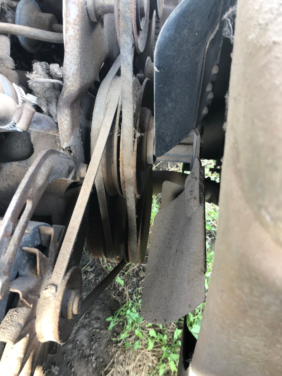

Anyone out there familiar with the high boy &(75) F250 a/c bracket hook up. My pump pulley off about 1/4 inch and I need to know if there is a spacer that goes bfetween the large bracket that holds the idler pulley and the power steering bracket. There is quite a bit of space there on the top power steering bracket. Is there a picture anywhere I could look at.

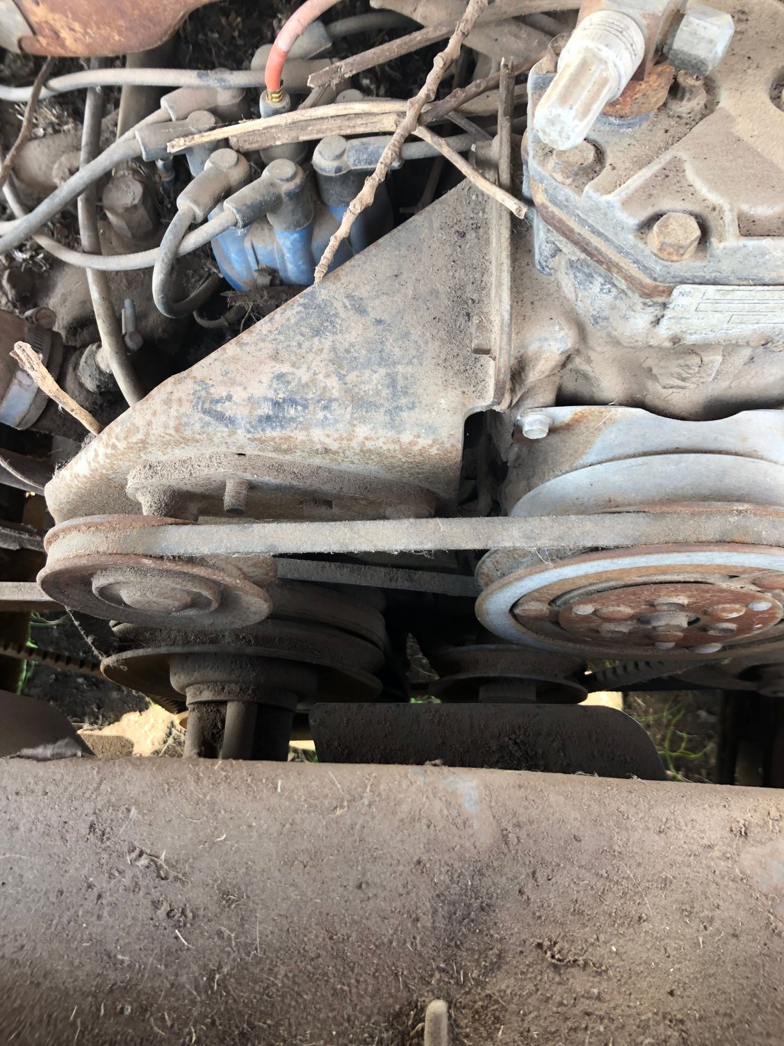

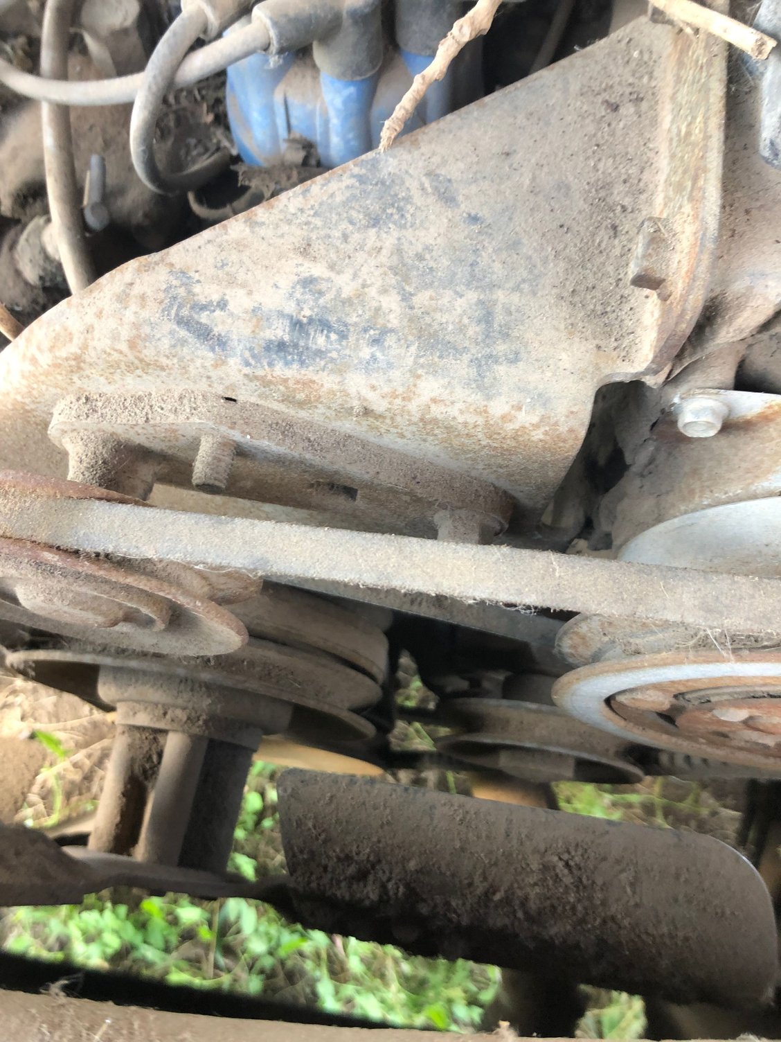

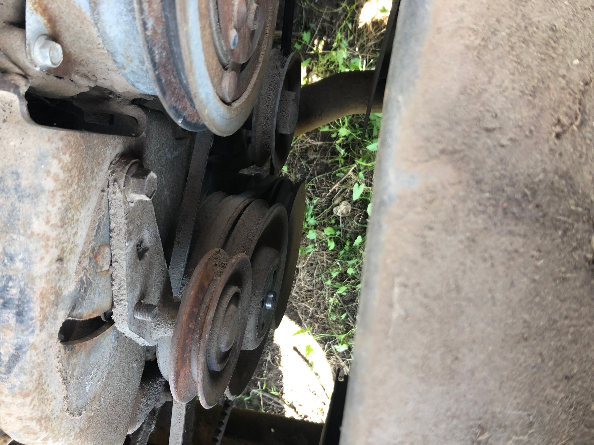

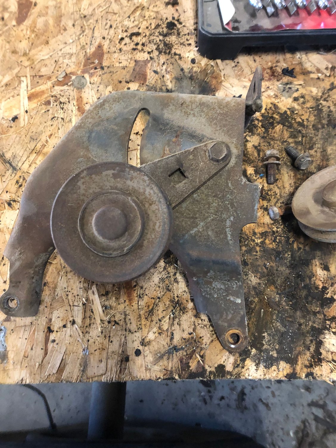

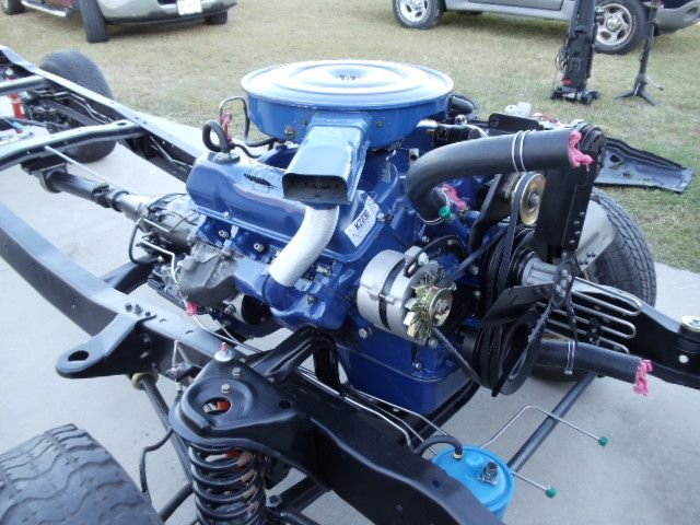

here are some pics off one of my parts trucks if it helps

Thanks, these pictures help some. I dismantled my truck 7 years ago and am just now putting it back together. I don't remember my 75 having a idle pulley under the a/c pump as shown in the picture. How do it mount to the motor or what bracket, etc. Also the picture looks a little off on the pump to the idle pulley to the water pump, maybe its suppose to be off a little. Does the top idle pulley bracket bolt direct to the water pump and he alternator and power steering brackets bolt on top of it. Wish I had some parts trucks. I need a crank pulley D3TE6312 AB also.

Was wondering if you had a 3 grove pulley for sale D3TE 6312 AB like in the picture. Thanks

I used that set in pics on my build but I have another pickup that I can look to see if it’s all still there

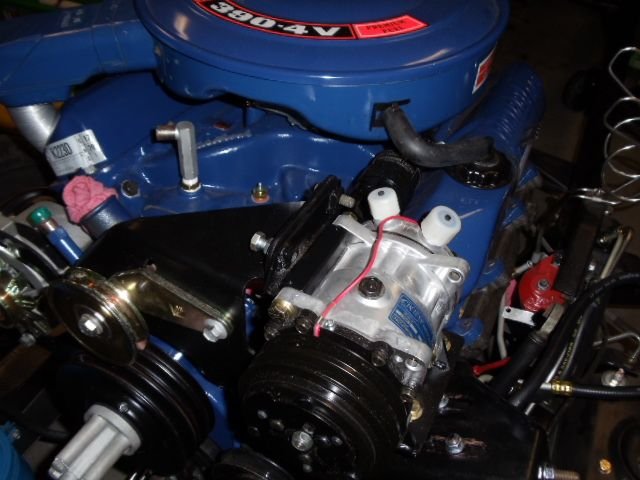

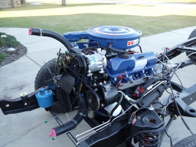

No but I converted to a sanden compressor and the plate I used that bolted to original compressor bracket had slots for a lot of adjustability

Do you have a pic of your setup?

Mine looks same as pictures in this post back on 12/16/19 with York type compressor and new Ford clutch assembly! Is that picture you want or of the sanden set up by dwirth.

I did the Sanden compressor conversion. I didn't like the compressor not tying to the bracket like the original set up so I fabricated a bracket that bolted the compressor to the idler bracket.
