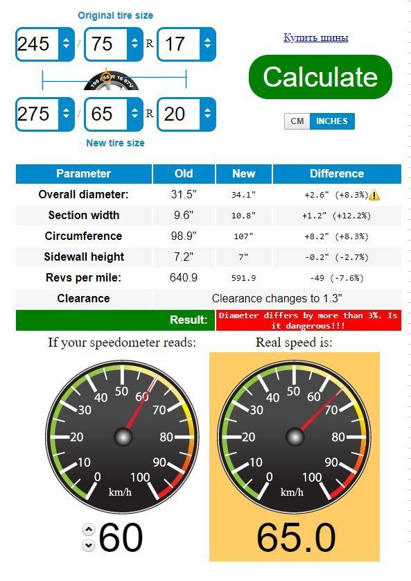

Switching to a 17" wheel would net a 2.6" difference in overall diameter. Since the radius is what you really care about, the difference is 1.3". This was based on the 2020 order guide, using LT275/65-20 and LT245/75-17 tire sizes. However, what also has to be taken into consideration is the capacity of that size tire and wheel. It may not be as much as either the 18" or 20" tires/wheels.
Smaller blocks for the rear axle is probably the least expensive option. To maintain a good loaded ride height for the truck it may also be necessary to reduce the height of the front of the truck.
I used a random tire size calculator for this.
