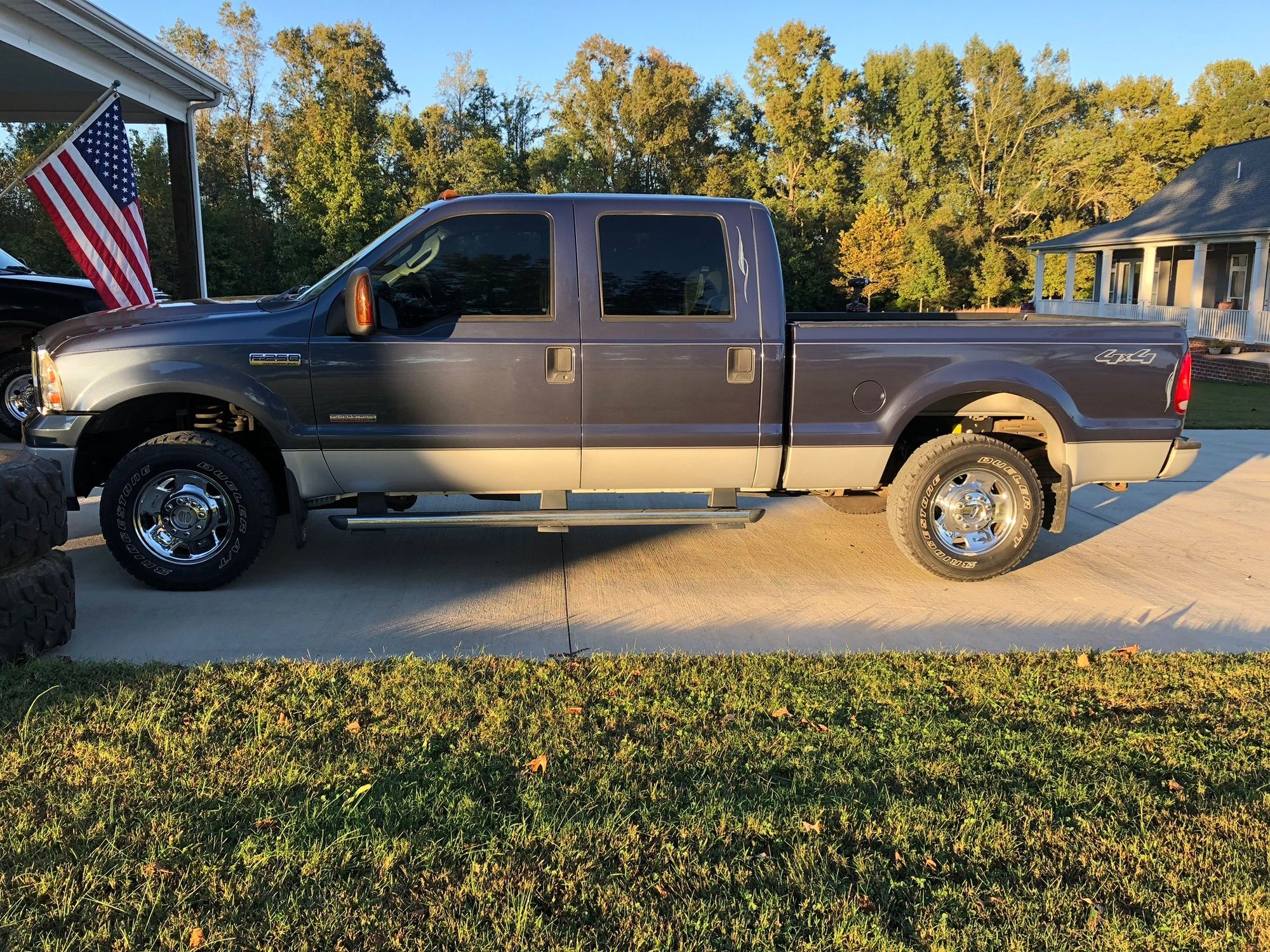

So, I’m getting ready to put a 2 1/2 inch leveling kit on my truck. I have read numerous posts but I’m still confused about caster. I don’t know if I need to get caster adjusting bolts/cams for the radius arms. I am also putting a 4 1/2 inch block in place of the 2 inch block in the rear.
It’s a 2006 F250 4x4 CCSB
