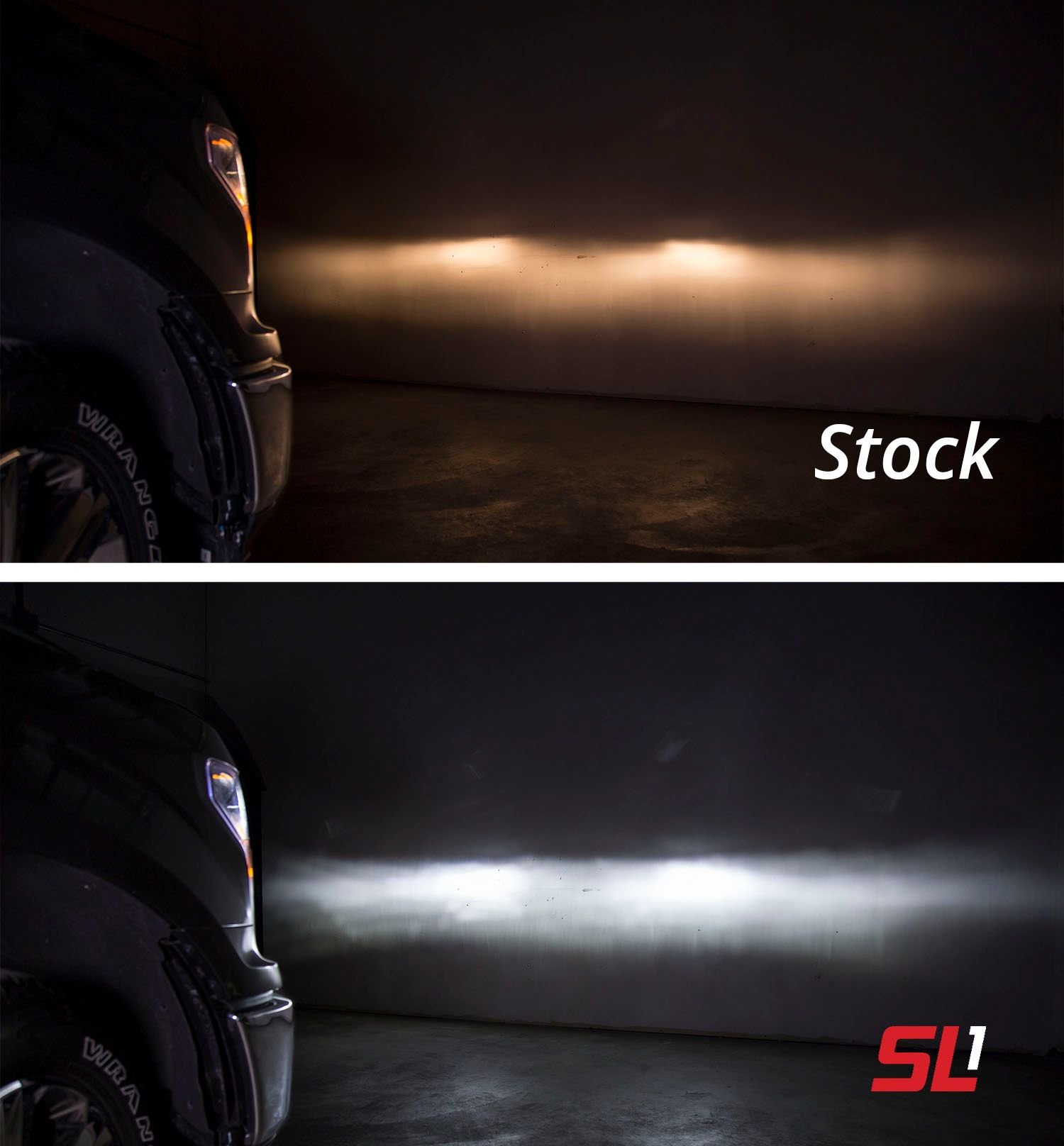

Old Dec 23, 2019 | 03:15 PM
Diode Dynamics's Avatar
Diode Dynamics
Former Vendor
Joined: Sep 2017
Posts: 524
Likes: 22
From: St. Louis, Missouri
Originally Posted by Flyct
I just bought a 2019 F150 XLT with Halogen headlights. Boy do they suck in rural areas.
My other truck is a '19 F350 with Factory LED headlamps. That truck does an outstanding job of lighting up the areas in front and throwing light to the side when turning into dark dirt roads. The F150 is scary.
This evening I just missed hitting a 300 lb wild boar that was crossing from left to right. Fortunately I was only gong about 25 MPH on the rural road. Besides having low candle power the area that the headlamps illuminate sucks. I may have to get add on LED light bars for the rural roads. Any recommendations?
If you are interested in a simple bulb replacement, definitely take a look at our SL1 LED headlight bulbs! They were designed to mimic the halogen filament location, so they provide more light to the road where you need it, without causing glare and blinding other drivers. If you do decide you want to purchase, be sure to shoot us a PM and I can send you our free shipping code!
