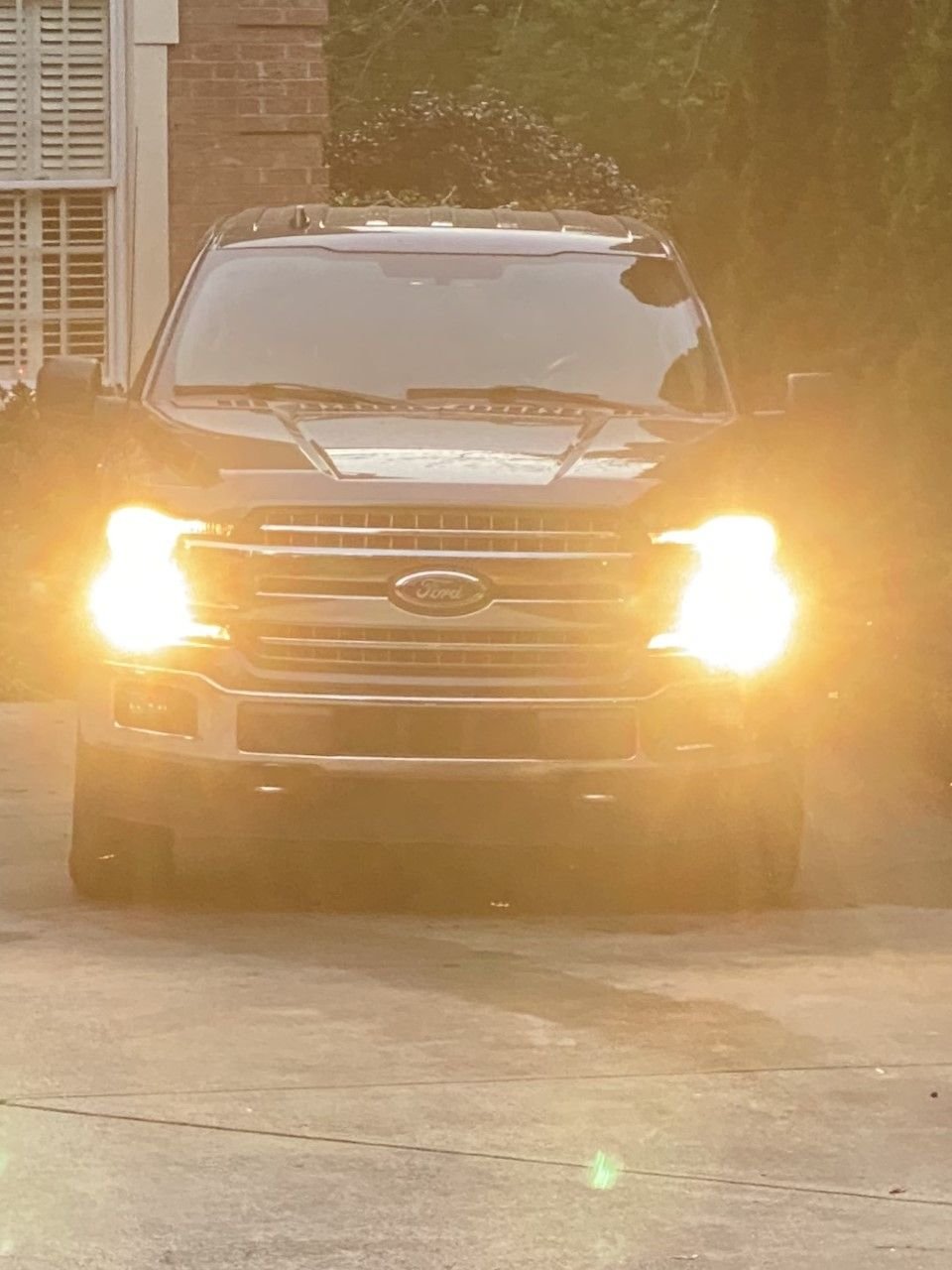

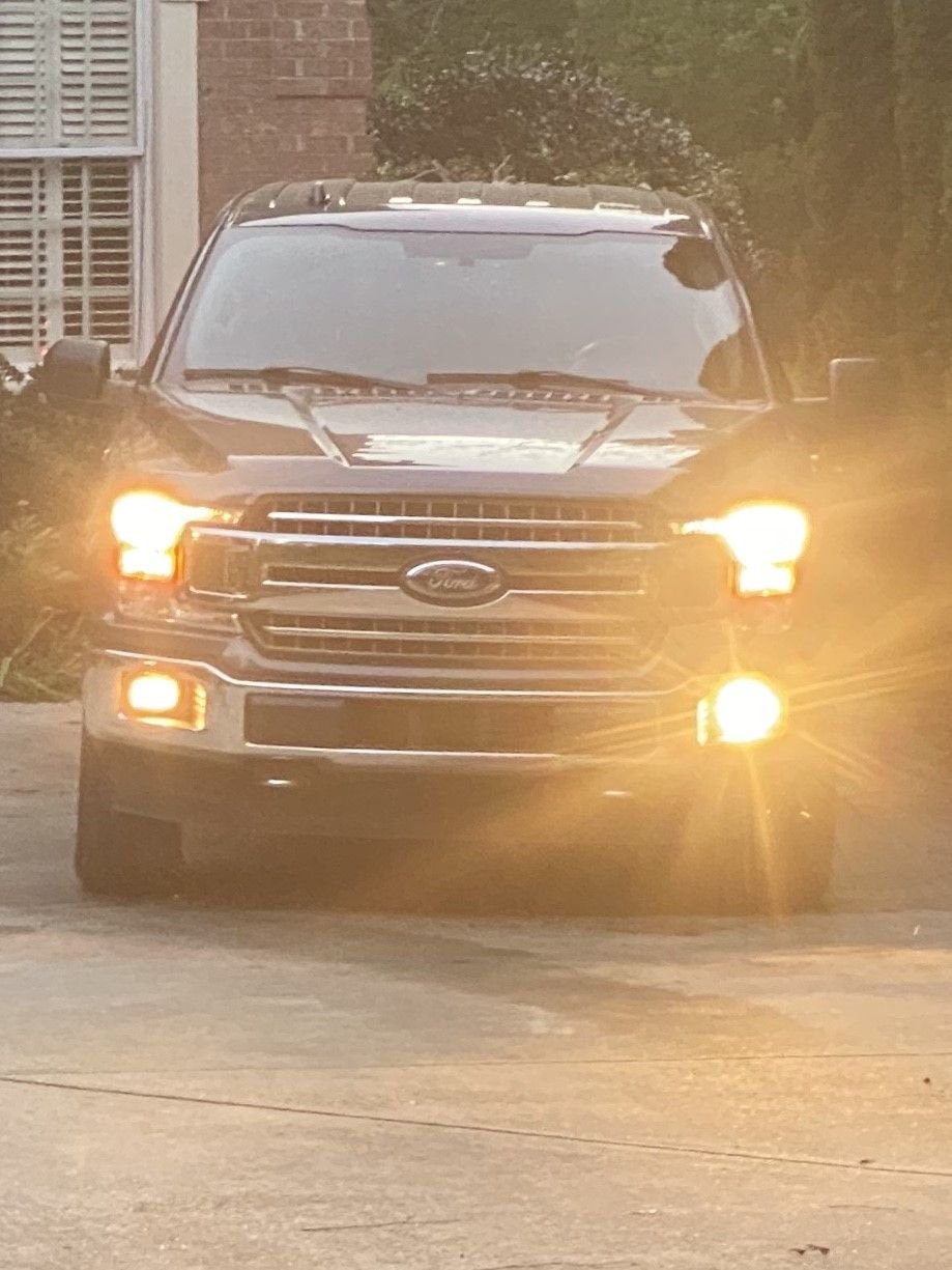

Just to close the loop on this thread I gave up on after market LED bulbs and went this route:
easy-headlight-mod
Low Beams with fog lights on (LHS new, RHS old)
High Beam (LHS new, RHS old)
Subtle but better.
