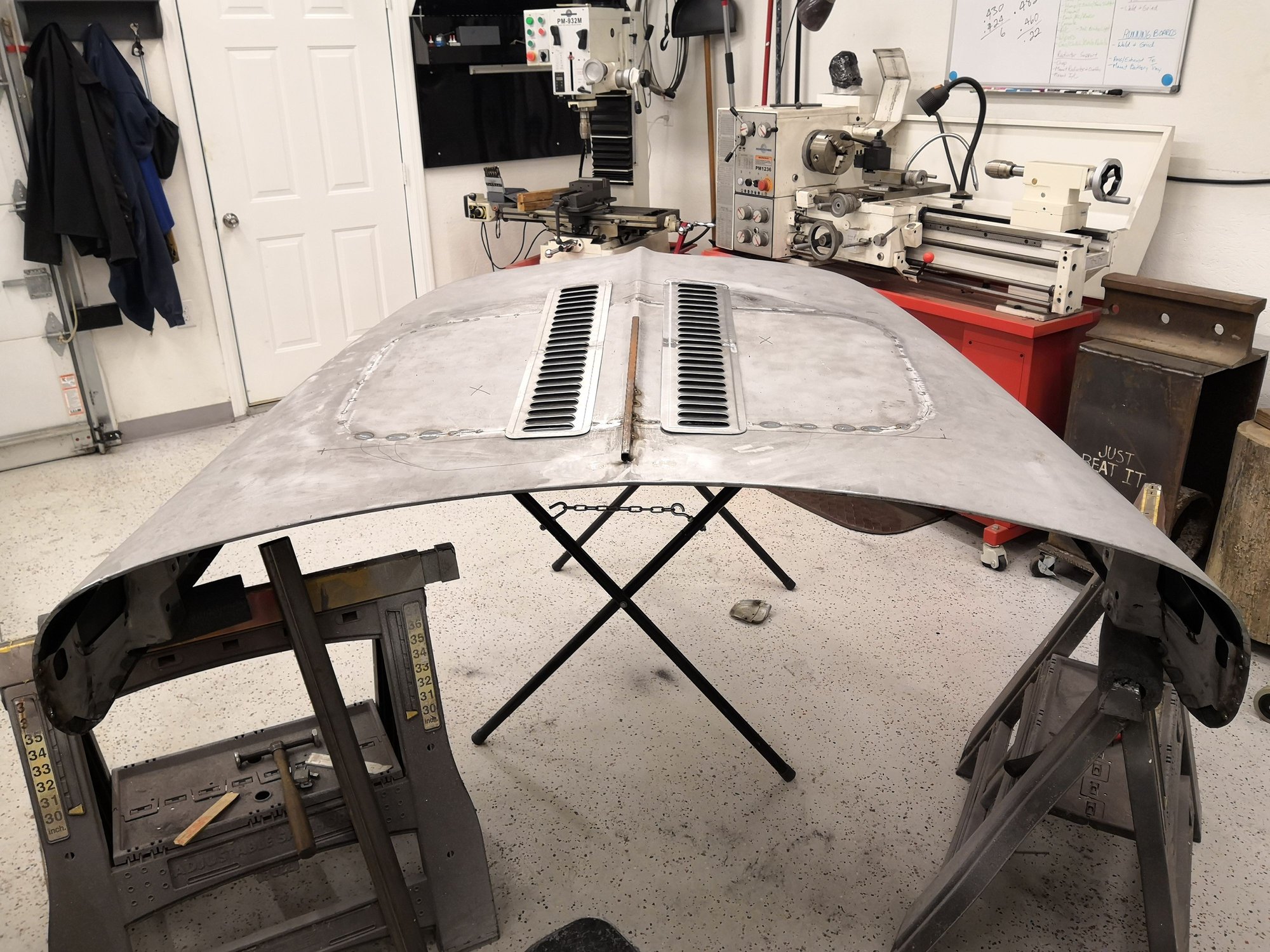

Precision. Mathews....
I use my mill all the time for drilling. Lathe doesn't get used that much, but when I need it, it's there!
Here's Mine:
