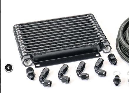

This is one of the best trans coolers you can get: https://www.ebay.com/itm/Tru-Cool-Ma...0AAOSwZVlXt1iJ

Truck had two when I purchased it, I was only aware of one. the one in front of the radiator with the fan. I added another because it was still getting hot when towing and idling. So I added another, now I am thinking maybe they are causing more hard then good. I do have a temp gauge the trans averages 150-180 depending on driving and eternal temps when towing I was seeing 220 and a little higher.
Does anyone else have any experience with the one posted above?
