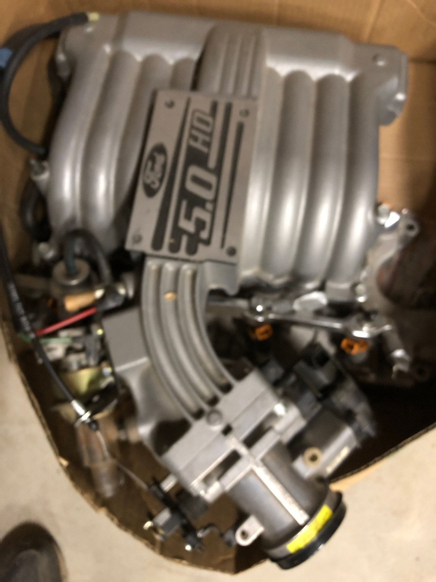

If you go HO this might help I could let it go cheap
This is a take off not new but never used

Originally Posted by schoo
If you go HO this might help I could let it go cheap This is a take off not new but never used
What kind of cheap please
How is that different from a stock 1992 HO ? Thanks.
I sent you a message and that is the same as a Mustang but never had engine running surplus ford parts
