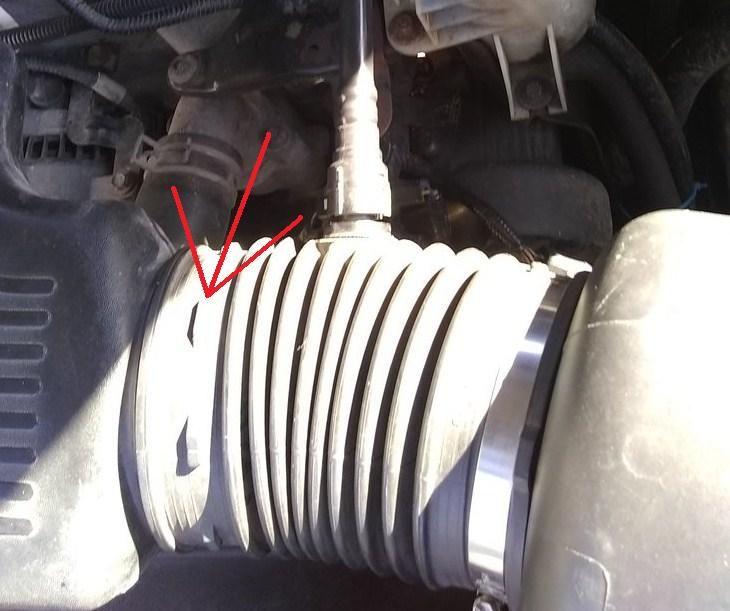

There is supposed to be a stainless steel clamp where the arrow is pointing.
I don't know. After looking at pictures on the web, I don't see any mid 2000's F150s with a clamp there. It seems strange, but I didn't see any.

Oh I see now. Mine is bonded to the plastic piece there at the red arrow instead of A clamp. Now I'm doing research to see if my dip stick tube leaking smoke will effect or cause my rough idle.
Actually, you now have three vacuum leaks:
>The PCV fresh air tube (see green tab)
>The leak at the MAF connector
>The dip stick tube.
Each leak may be small, but combined they may be significant.
