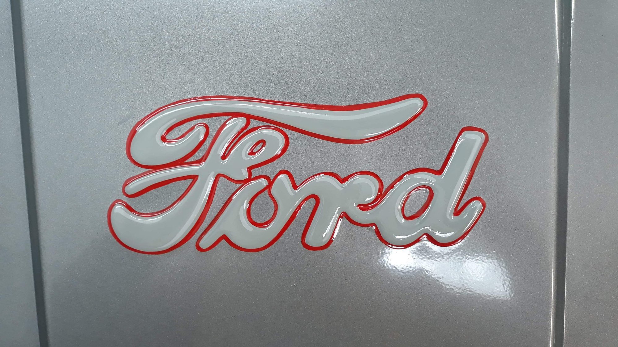

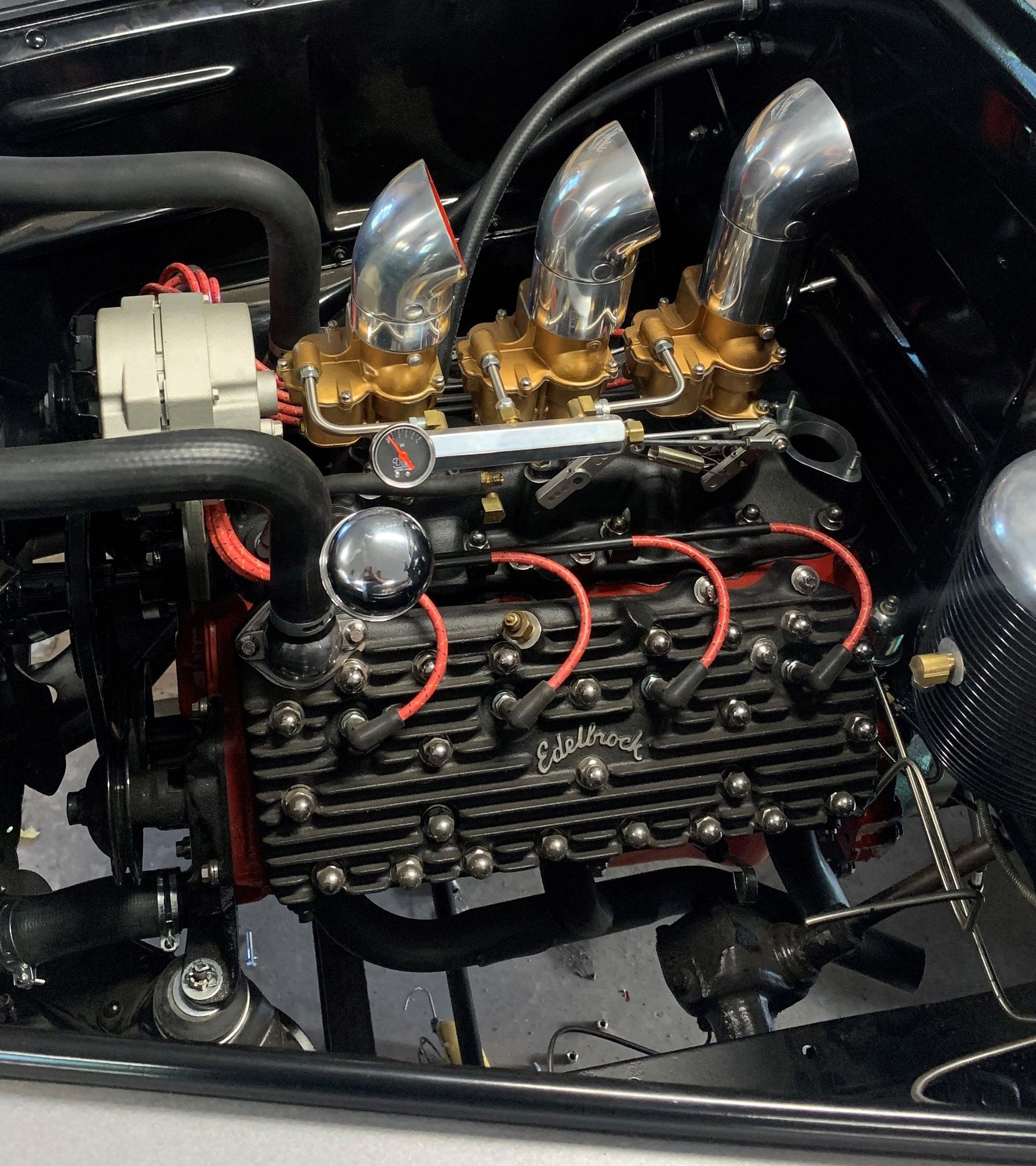

We got the engine back in the truck and also I got some pinstriping done!
Refreshed engine installed in truck

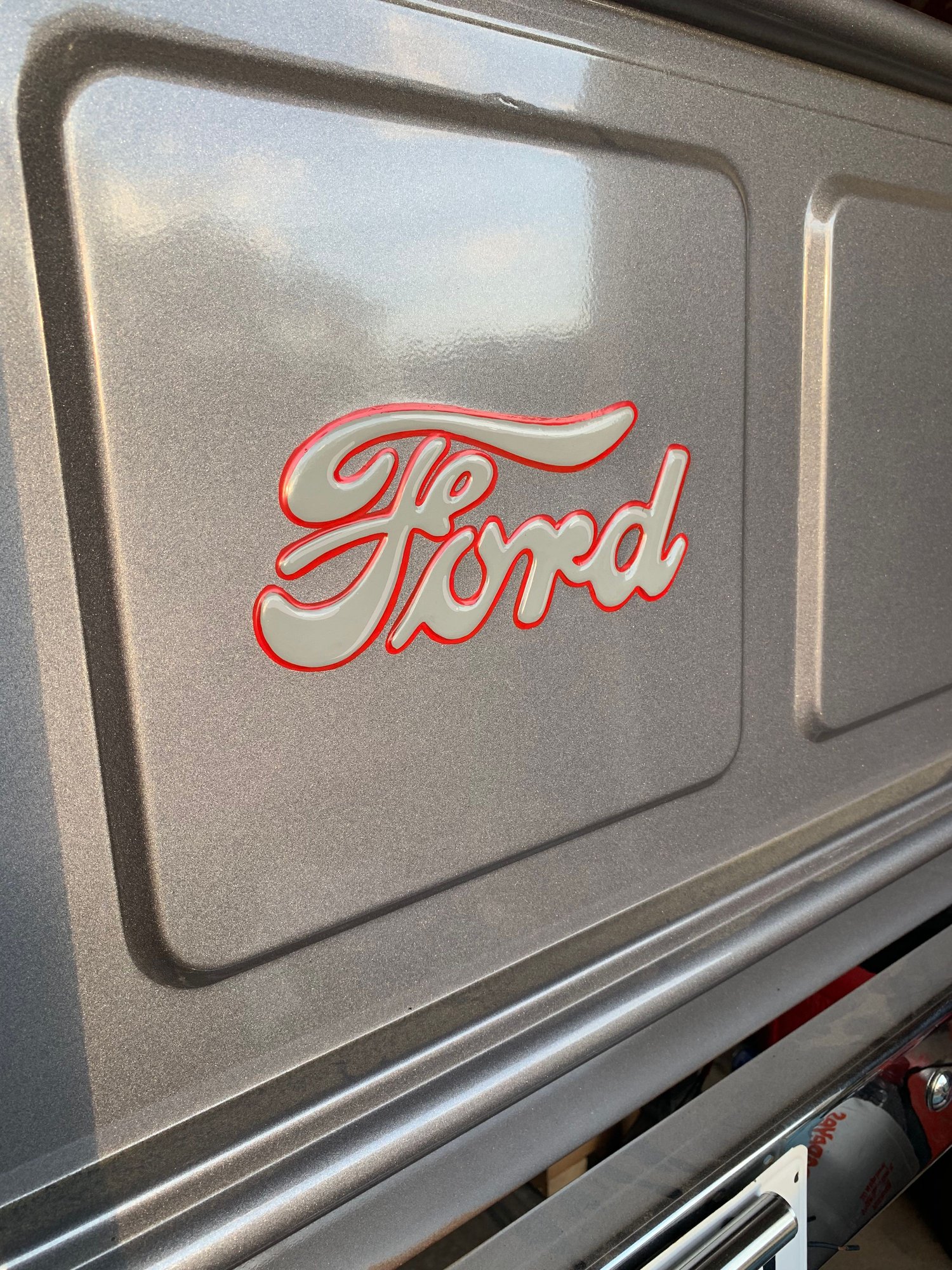

Another shot of tailgate.
Hand painted by Donnie Strother

Engine is GORGEOUS!!!

That is one nice looking piece of machinery.
What's inside, if you don't mind me asking?

It is a 1949 8CM Mercury 255 bored .60 over with a Winfield 3/4 cam, We went with Edelbrock's powder coated intake and heads with original period correct Holley 94 carbs.

Your engine is gorgeous! I noticed the Road Draft Tube is missing. Did you remove it to enable the wiring loom metal tube installation? I'd like my wiring to look tidier but the metal tubes that are sold don't fit with the Road Draft Tube in its original position.

He appears to be running a PCV system.
Nice work on the spark plug wiring, Nails! Really shows off the heads.
