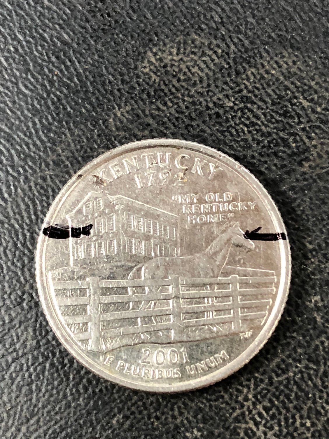

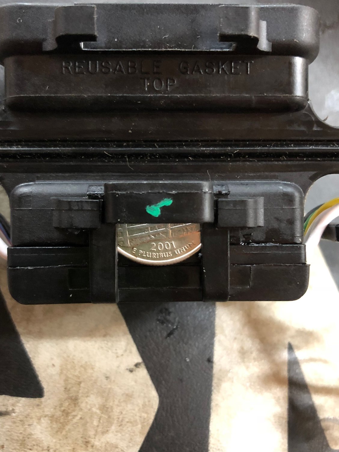

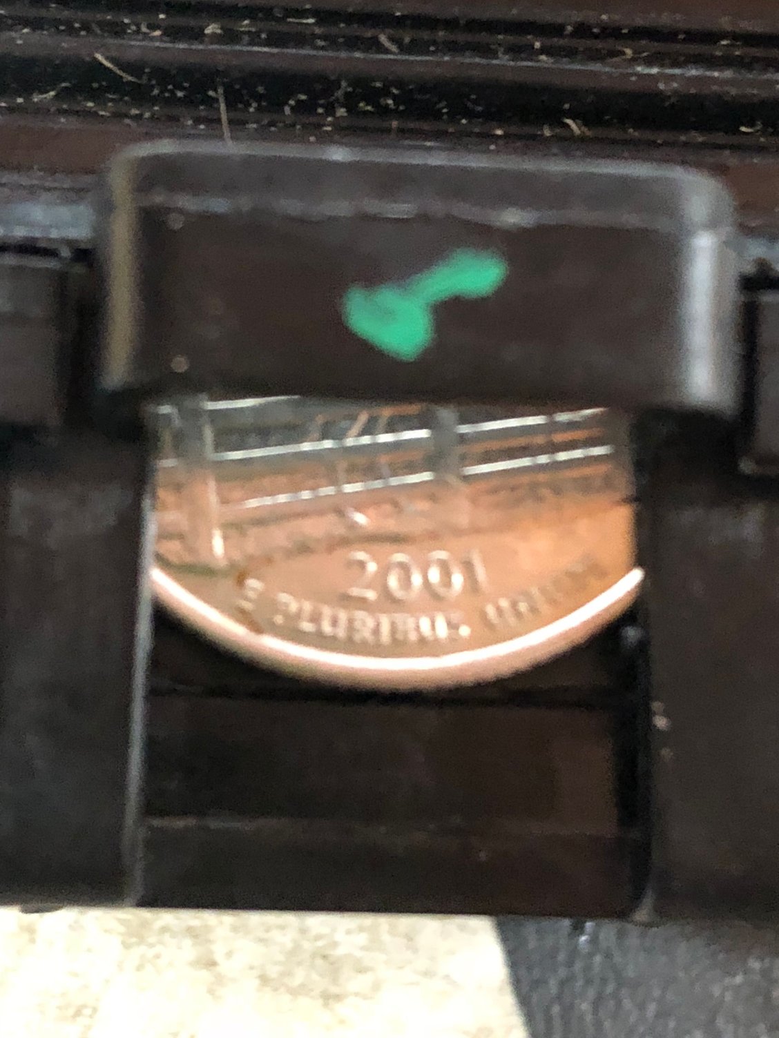

When I replaced mine I did the $0.50 mod mainly for nostalgia. One side got a 2001 KY quarter in honor of the year it was built and at the Louisville truck plant. Other side got a 2018 CO quarter for when and where I got the Excursion
