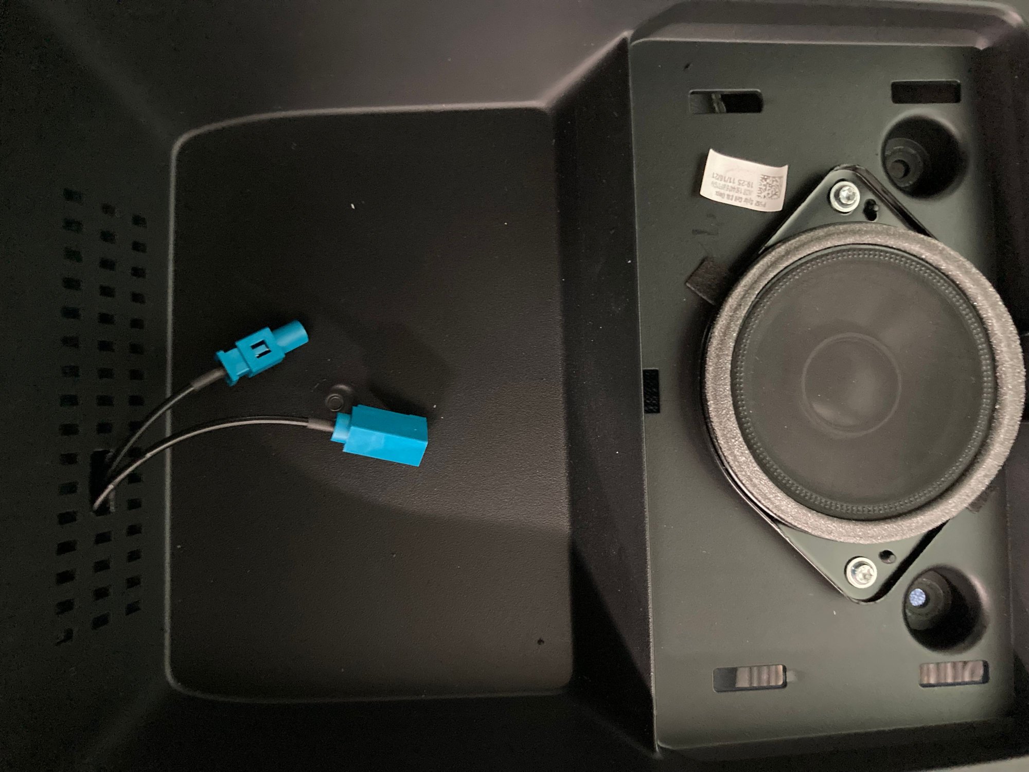

I finally got around to cutting the cord on my 2022 Lariat F250, at least as much as any of us can with these trucks. I swapped the modem fuse for the 2-prong version, and then I got curious about the TCU. So I dug into that and disconnected all of the inputs/outputs to and from that thing (probably not needed, since it doesn’t have power with the fuse pulled, but I was there anyway, so…). That takes care of the cell tower comms.
I also dug into the antenna system for the GPS. At first, I thought I would put a disconnect/cutout switch in-line near the driver’s side antenna on the roof (top of the C pillar). But that would kill the Sat radio also. After looking at the schematics, I wanted to see if I could place the disconnect setup closer to the GPS input to the APIM. It’s pretty easy to access it- pull the speaker cover and the top center dash tray, and it is right there near the top. I used two 12” universal fakra cables, connecting 1 to the input on the APIM, and one to the antenna wire. I then fished the other two ends through the vent area in back of the dash tray (I had to cut a little bit with the dremel).
By doing this, I have a quick and easy way to connect the GPS antenna if I want the truck to get the GPS feed... and then disconnect it when I don’t want the GPS feed coming into the system (vast majority of the time). That should prevent the truck from geotagging any of the data it does collect, at least through the truck’s GPS system. Connecting your phone to the truck would probably negate that though. I'm not sure what data is skimmed from Apple CarPlay or Android Auto...

I never factored GPS into the equation at all, so thanks for the pics and procedure. Could you please post links to the source where you purchased the fakra cables? Many thanks!
Old Oct 12, 2023 | 06:49 PM
  #44
wrench69's Avatar
wrench69
4wd Low
Joined: Oct 2021
Posts: 10
Likes: 18
I went with these:
Amazon.com: Bingfu Fakra Z Female to Male Vehicle Antenna Extension Cable 30cm 12 inch for Car Stereo Android Head Unit GPS Navigation FM AM Radio Sirius XM Satellite Radio 4G LTE TEL Telematics Bluetooth Module : Electronics Amazon.com: Bingfu Fakra Z Female to Male Vehicle Antenna Extension Cable 30cm 12 inch for Car Stereo Android Head Unit GPS Navigation FM AM Radio Sirius XM Satellite Radio 4G LTE TEL Telematics Bluetooth Module : Electronics
Amazon has a ton of choices for these cables. The "Z" version is universal, which will fit all other fakra cable connectors.
