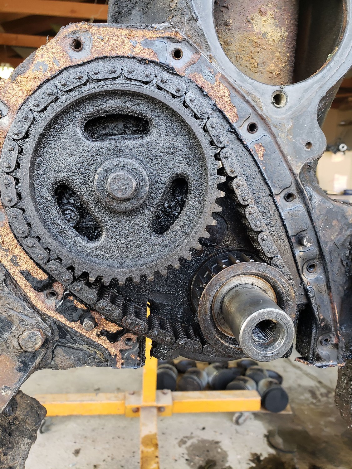

Back at my engine at last. Very strange but finding engine in pretty good shape. In another post it was determined engine is a 1960 223 car engine. Nothing indicates engine has ever been apart. Standard rod bearings in good shape with 1960 dates. No ridge in cylinders except a little carbon in top. No oversize numbers on rod caps, pistons, etc. Have to mic everything yet. Timing chain completely worn out. I could almost lift chain off gears so it has plenty of miles. So far it looks like I can avoid the machine shop.

timing chain looks like how I feel sometimes.

Looks like that engine has never been run on more modern oils, the good old days of Quaker Sludge

Quacker sludge
Growing up helping at my Dad’s auto shop I can relate to that. I can remember removing valve covers and it looked like a solid mass where you could not see the rocker arms. And then under the intake manifold removing the sludge by the hand full!

On the plus side, I finally justified buying the parts washer I always wanted. I changed the oil and cartridge filter way back when I bought the truck. Poor thing only ran a few times each year hauling tree branches to my burn pile and a few days every few months hauling blow sand back to the dry river a half mile away. Should have done it annually I guess.

It was more than likely all slugged up before you got it from older oil.
