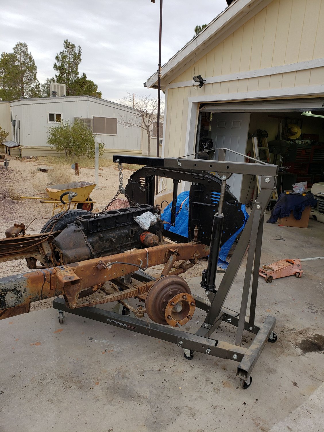

I decided to pull it out. It isn't as cold here as some places, high twenties in morning and 50 if lucky by noon but the thought of crawling under again on that cold cement was too much. Will have it out tomorrow.

Got it out easy enough. Just curious if you pulled and reinstalled your engine assembled? I was able to use short 7/16" bolts in head bolt holes. There is not many places to chain onto the passenger side with head on. Just curious.

Yes, I used the head bolt threads as well. Ford used to sell a special tool/hook, that went down between and under the manifold which you could pull it with. (pics of it have been posted here and it is pictured in the factory shop manual), I didn't mind having the valve cover of anyway since it is so tight when pulling that long thing out with the front clip still in place.
So, did you torque all the head bolts after putting rebuilt motor in truck or just the two you lifted it by?
Mine came out pretty easy. Had to remove front wheel t get hoist in from side.

My question was about torquing the head bolts. If you torque the head bolts and then removed two to pick up engine or torqued all after putting engine in? Or put block in and then installed head?
I would not lift the assembled engine by 2 head bolts without the remainder being tightened first, too much chance of the head/gasket/block moving in relation to one another and causing a leak.
I would torque all the head bolts, remove the two you need to lift the engine and install block and head. After lifting reinstall the two head bolts, tighten, then re-torque all head bolts.
I would also consider installing the engine, then the cylinder head. The lift will be easier and the engine is very accessible. In this case, I would not use head bolts to lift the engine as you stand a chance of bending one. Use a correctly sized, shorter bolt which will also give you more height to get past the radiator support.

Yes, I used short bolts when I removed mine as I had removed head first. I was concerned about putting it back in. I know you are supposed to tighten and torque in sequence. I didn't know if it would affect anything removing two to lift.
