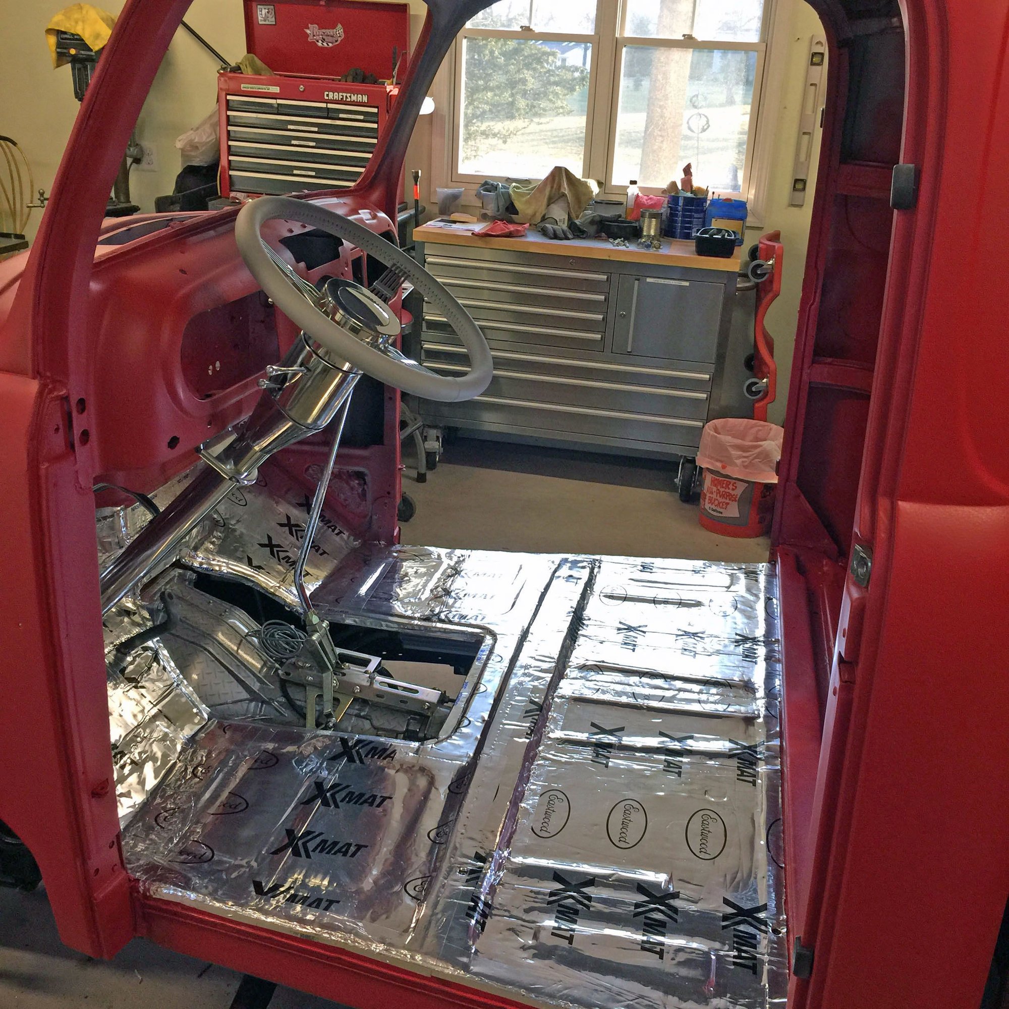

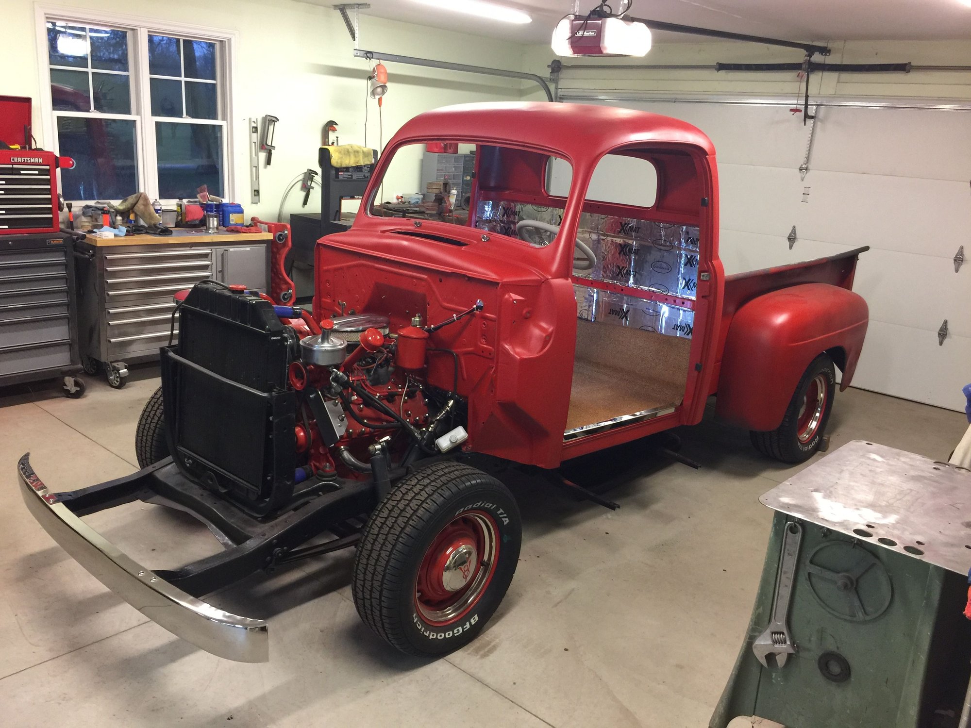

I would pull the tank out of the truck. It is a pretty easy job one drained. That is a prime spot for rust. Also a good time to clean out the tank thoroughly and check for leaks. Also you might want to consider installing sound deadener before putting in your new carpet. It makes a big difference. (Be sure to wear gloves).
With new carpet
