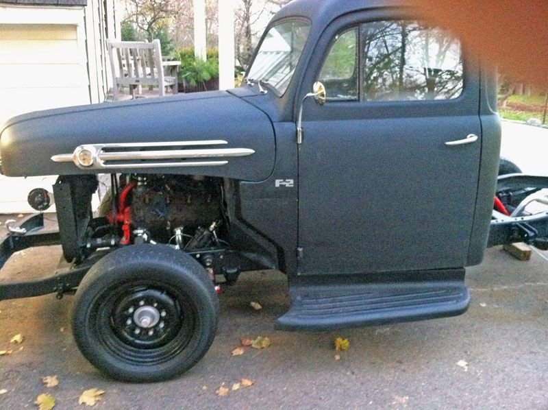

Here is a hidden spot you wight want to check. This is the cab where the fender welting rubs. If the truck has been used a lot you might have rust through like mine. It might be easiest to check from the inside with the kick trim panel removed.
Of course they do make patch panels:
Patch panel installed
