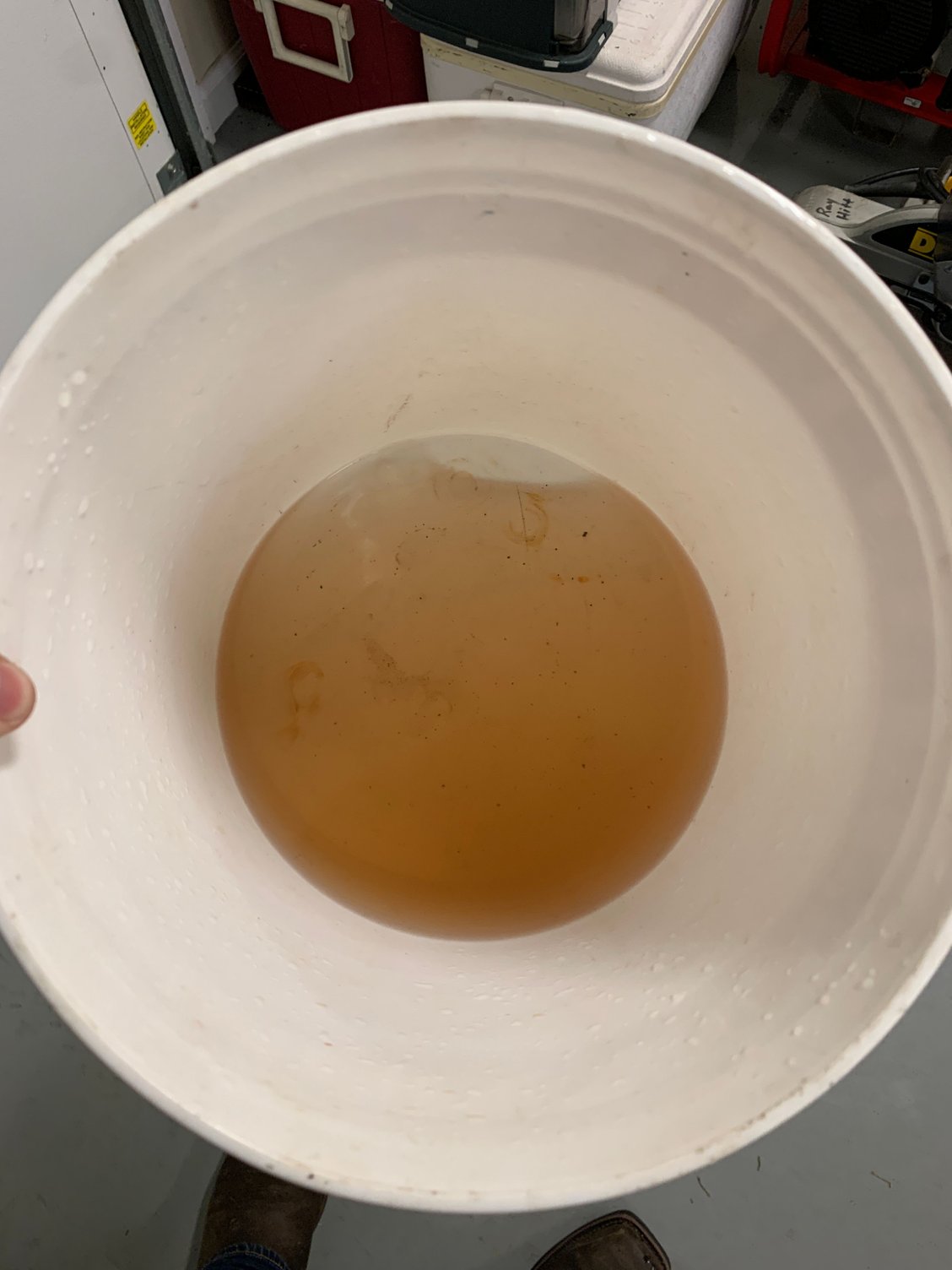

Alright, been running chem flush since Tuesday. Got home today, drained it, added new water, and drove it down to the Ford dealership to pick up some Motorcraft coolant. I just went ahead with the green concentrate. Got two gallons of it, two gallons distilled water. Broke the bolt on the petcock, replaced that. Now I’m attaching pics of what I drained out. Right bucket is the first flush, left is the second. The second pic is of a smaller sample I caught from the drips running across the frame, you can see it’s a lot lighter colored. I know it’s harder to tell how nasty it is with the dark bucket, but do y’all think I’m good to go ahead and add new coolant? I don’t know if this orange color is being made by rust, or residual orange coolant. IF there is residual orange coolant, wouldn’t it be diluted enough by now to not do any harm?

Yes, your good to go... After a couple flushes you should not have much if any of the ORANGE left.... Should be just rust at this point........ you can see the bottom of the cup....
I would say it had orange coolant.

he has drained and flushed it 3 times and run a block cleaner thru the system for a couple days.... should not be much if any old antifreeze left... maybe just rust/ block cleaner / residue... and not much of that now.
one way to check for coolant is to use the suction tube with 5 ***** in it to see what the freeze point of the system is.... but you should have so little coolant left after 3 flushes that I bet the drained stuff reads 32 degrees.
