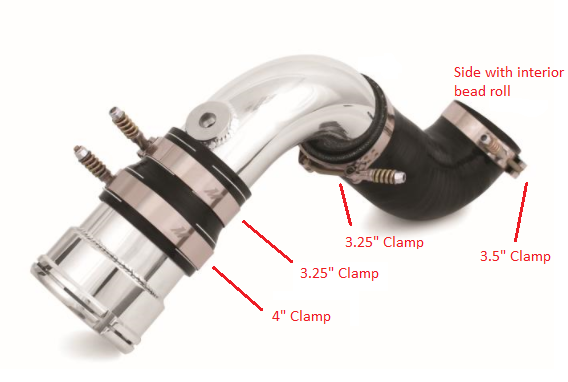

During the Black Friday sale I bought a Mishimoto cold side air to water intercooler kit. I had planned to hang onto it and install if needed but as a former 2005 6.0L owner who heard several loud booms as my intercooler blew a hole in the plastic and later as I was looking for a better pipe, several pipes blew off until I found a fellow who made braces to hold the pipe in place. So I now wonder if the plastic Ford decided to use instead of the solid metal connection actually breaks often or is it far and few between. I have 36k miles most of it towing and would like to keep it on the road opposed to off to the side. How often do people see this plastic part blow like the old pipes. The downside is I don’t want to make a change and create a problem. The dilemma.
