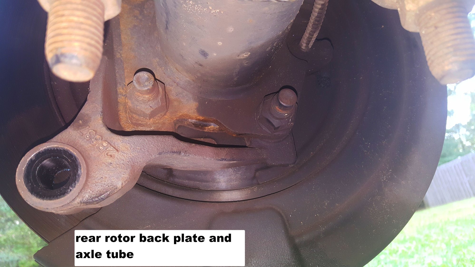

I have the same issue and found out the axle seal is leaking and oil residue is on the drums.
I attached some photos. ​​​​​​​

Wow, I don’t see any evidence of leak outside like that, but definitely time to get in there and inspect thanks for the information that could be the problem
​​​​​​​This happened in my 2005 too - my guess is this would be your problem. Not cheap to replace either!!! If it's oil leakage I would think it would be warranty for axle seals.
