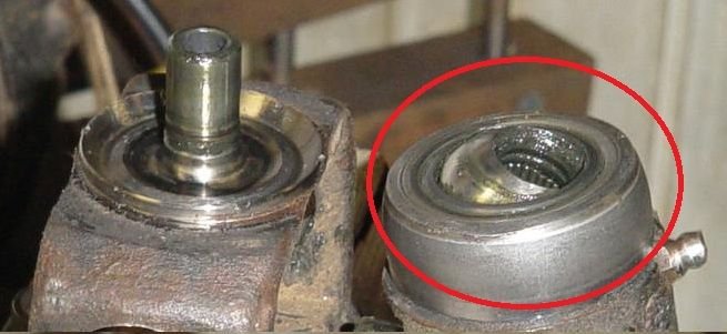

yeah, the centering assembly is trashed on that Double Cardan CV Joint
You may have to replace the Yoke on the Drive Shaft itself too... you will know when you get it apart.

"U" joints alone will not fix it.

You've got a constant velocity U-joint. You need the whole assembly, it will be the 2 joints and center section just like your vid.

What you will need is 2 "U" joints and the Cardan joint Rebuild kit .. IF the Pin is Worn out then you need to either sleeve it or replace the Yoke on the Drive Shaft...
IF the pin on the Left side is all worn out then it won't help much to Replace the "Kit" shown on the RH side
EDIT: IF you are not a Mechanic and don't have the tools required I suggest you remove the Drive shaft and take it to a "Drive Shaft Shop" they repair these things Daily.

IF you buy the complete Joint then you will need to take the drive shaft to a shop and have them install it an Balance the Shaft.
