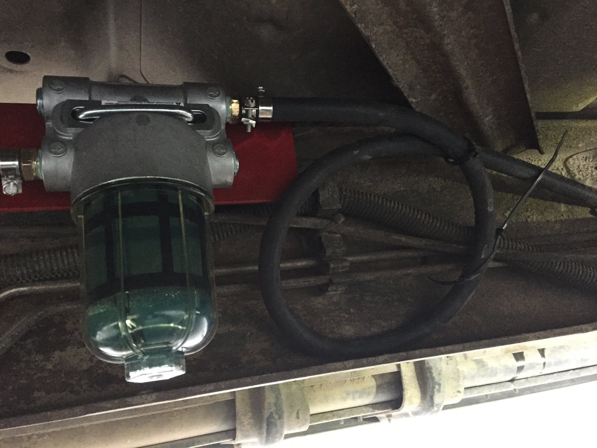

If you’re gonna drop the tank order the Racor filter, 3/8 fuel injection line, Fuel injection clamps, 2 compression fittings. Google hutch/harpoon mods and be done with in tank issues.
I left a loop on hose both sides so if I have to remove it I have extra hose and can simply cut the ends off and start with solid hose. Otherwise, you may have to drop the tank again to add a new hose to reach the Racor filter.
