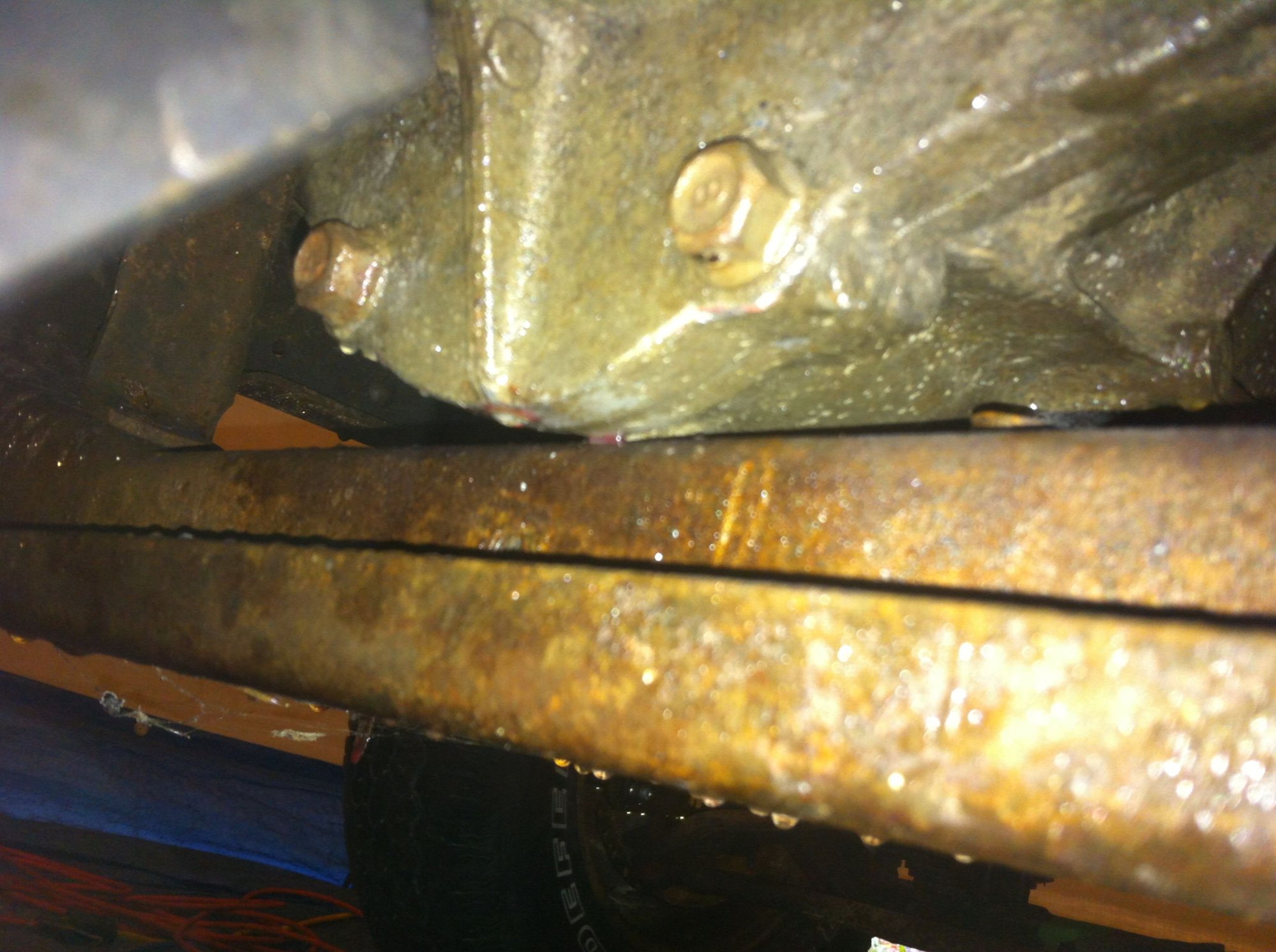

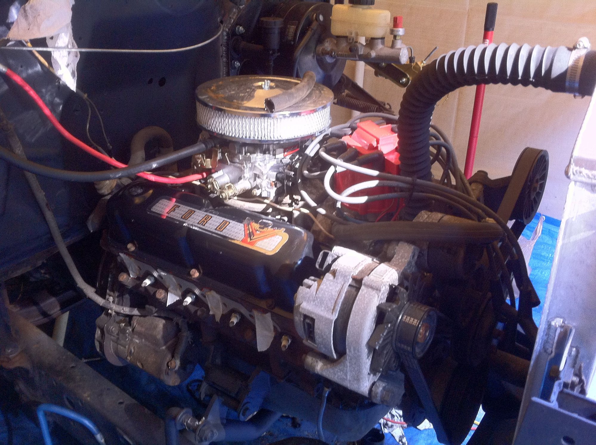

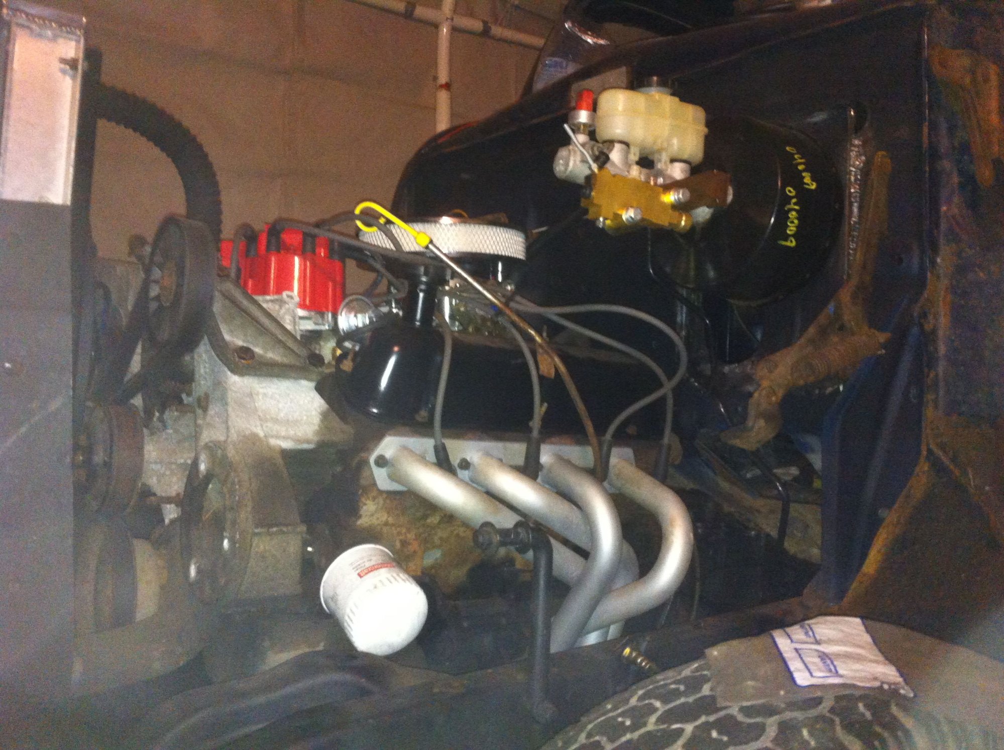

This is my setup. Off the shelf motor mounts, champion 3 row and longtubes for an 89 ford. Cut the brake booster plate from the donor truck firewall and used it's pedal bracket with fabbed pedals.
Motor is mounted with a 3/4" offset to the passenger side, placed it so the headers would clear the steering box. Radiator fits in the straight six position.
It will mount without removing the transmission crossmember but it's about an inch higher and an inch and a half farther forward than would be ideal and i would recommend removing it. But it's a beam axle truck without sway bars so it's not like i'm losing a nurbrug ring lap record to it. I'll just claim its gasser geometry. The pinto short oil filter clears the stock motor mounts but not the full size one. Also the '89 f150 starter relay bolted straight to the firewall, because of course it would.
