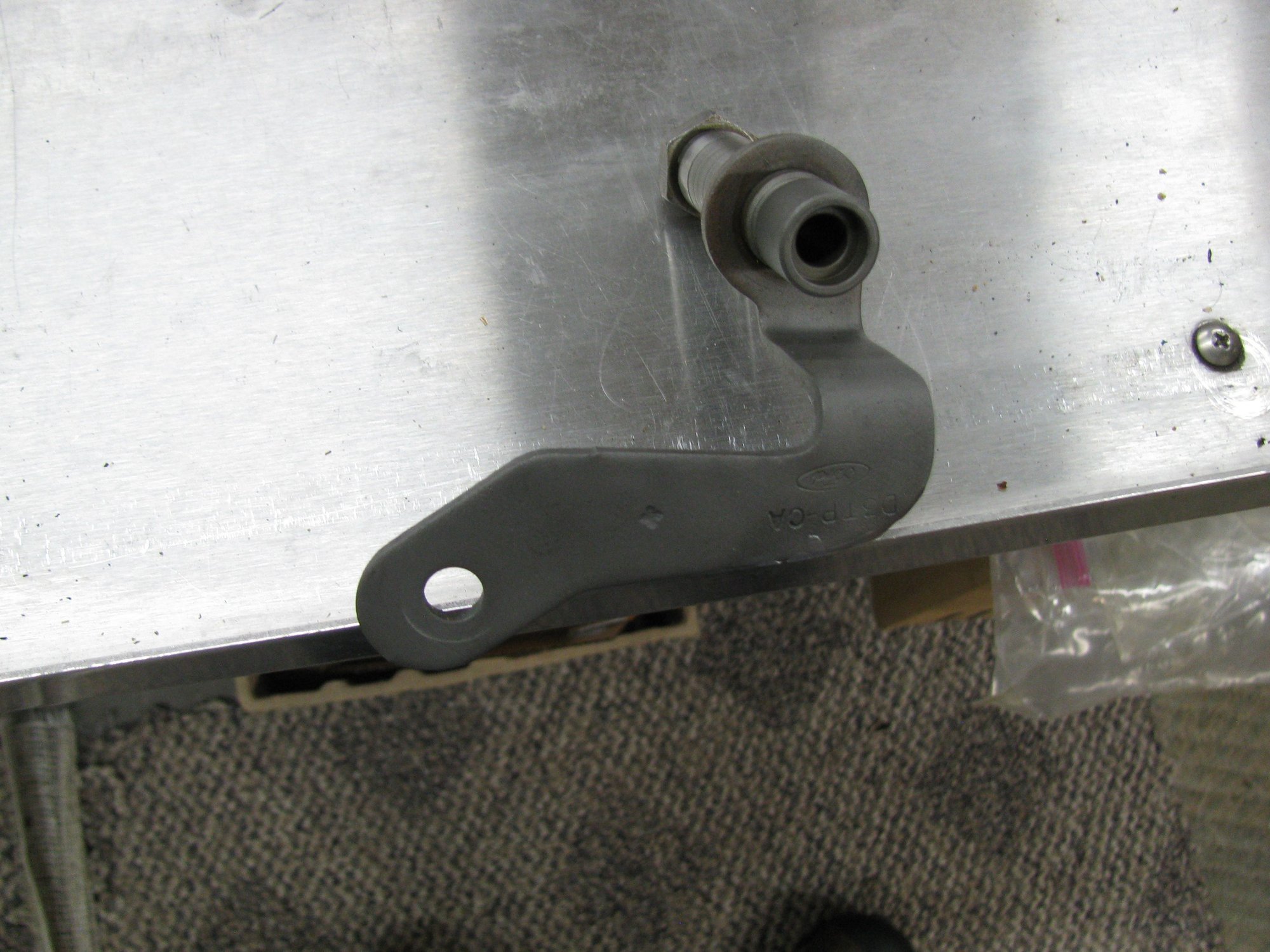

Here what I have...
Yes, also fighting a transmission leak. Its overfilled by alot from prior owner. Im hoping thats why it leaks, but at some point need to learn how to do the seals on the shift lever. A little afraid of the valve body...anyways, no tag, but took a pic of a stamp on the transmission. Im hoping I can get the correct linkage, replace the seals, replace the pan seal, and correctly fill all in one fell swoop.

I do not believe that is the correct selector shaft (lever) for a truck column shift. I believe a truck type lever is longer.

That isn't the correct manual lever for a column shifter in a truck.
Maybe ND will give you a part number and engineering number for the correct one for a 1972 F100 with a C4.
I'm not sure if the manual levers are interchangeable between a C6 and a C4 but this is what it should look like. This one is from a truck C6 and is stamped D3TP-CA
In order to change the manual lever you have to remove the valve body. You might want to take it to a shop if you don't feel confident getting that far into it yourself.
The leak I'm seeing in your picture isn't the manual lever seal but is the kickdown lever "O" ring. That is an easy fix just remove that nut and the kickdown lever and put a new "O" ring in it.

D0TZ-7A256-A .. C4 Manual Control Selector Lever / Marked: D0TP-7A256-A / Obsolete
1970/72 F100 / No one has any NOS, none on ebay.

That manual lever looks about right. But with all those pictures none show the number stamped on it. I would get in touch with the seller and ask what number is on it. ND can use that number to see if it really is what they say it is. And remember this is the World wide web so anyone else that needs one may be reading this also.
