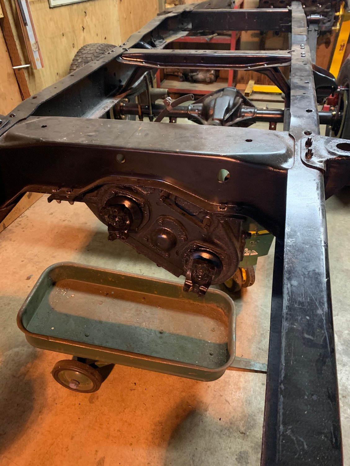

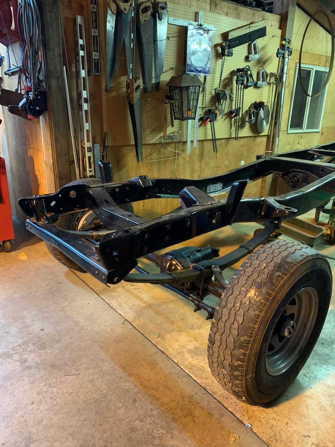

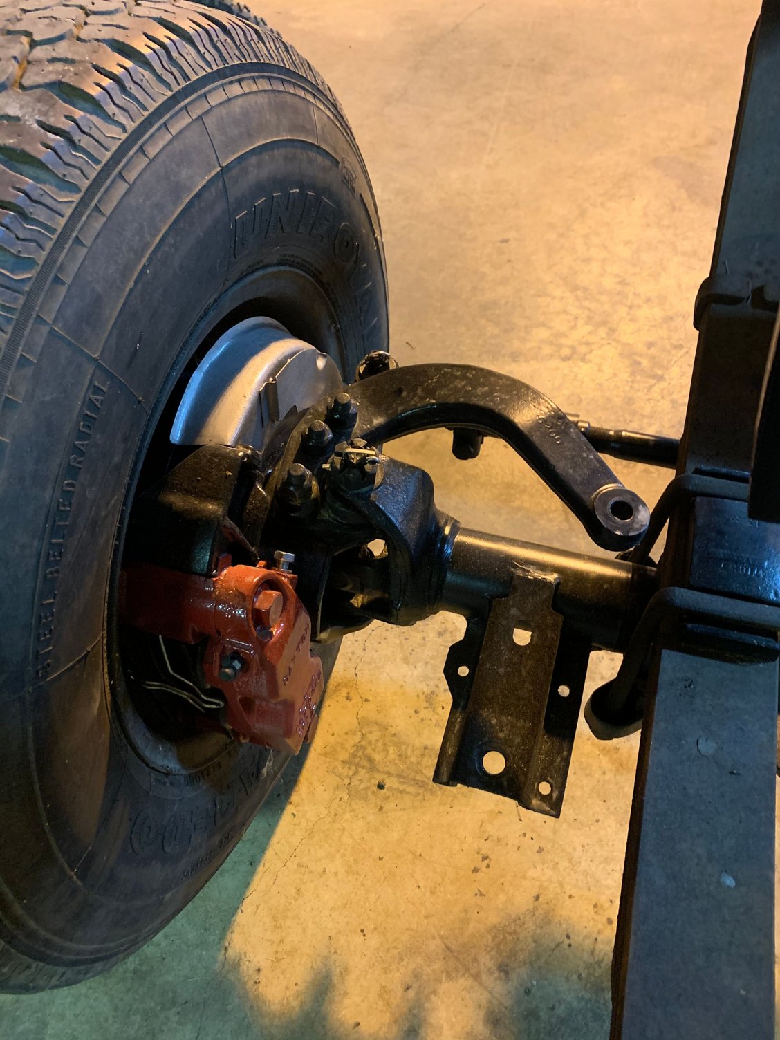

Here the setup showing both the front and rear differentials, and the disk brakes on each...
Frame 1971 F250 High Boy with 4 Bolt Steering Box Modification
Rear End 1971 Dana 60 Limited Slip w/GM Chevy Disk Brakes
Front End 1977 1/2 Dana 44 Open Knuckle High Pinion w/Factory Ford Disk Brakes
Transfer Case Dana 24 1971
Thanks for the info on the 70s to 80s GM Front Calipers being used on the rear.
I was wondering about the parking brake issue. I read that I could use the caliper from an Eldorado and use the existing mechanical emergency brakes pedal and cables. I'd like to keep the same setup in the cab and cables and not covert to another type of system. Will need to figure that out as I get further along. I'd like to do the disk brakes, but I'd rather go back the the drum brakes if the emergency cable is not going to work.
