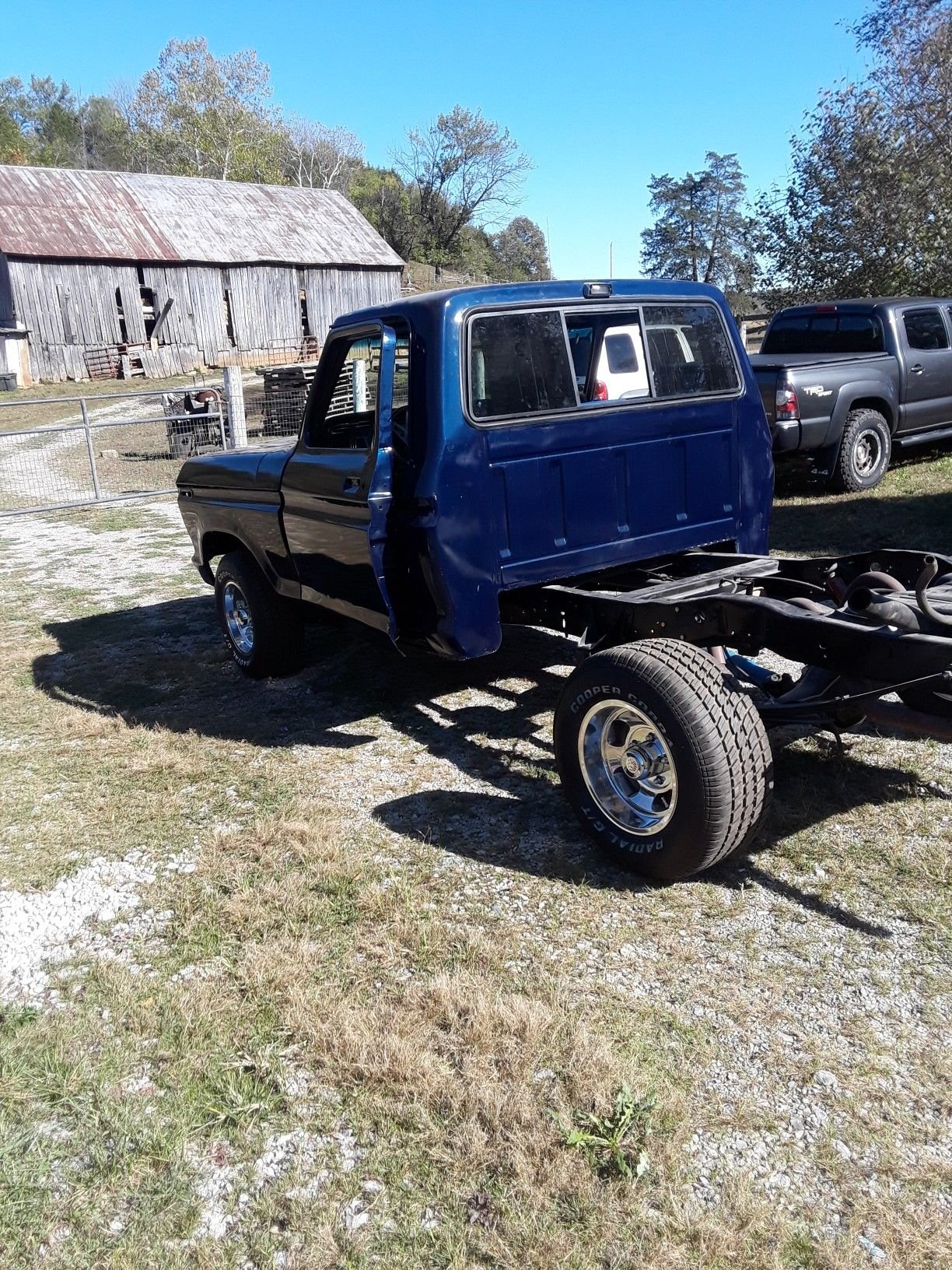

I used those on my 79 f100 , they look great

If you go to my build link you will see some more pictures just havent got bed done yet and I did not use a 10" on the front,,also the center cap in picture is wrong and they do not come with them, I had to order separately

I used the 15 x 8 on front and no issues of clearance with calipers on a 79 f100 , but you should check all your options as once you buy its hard to return
