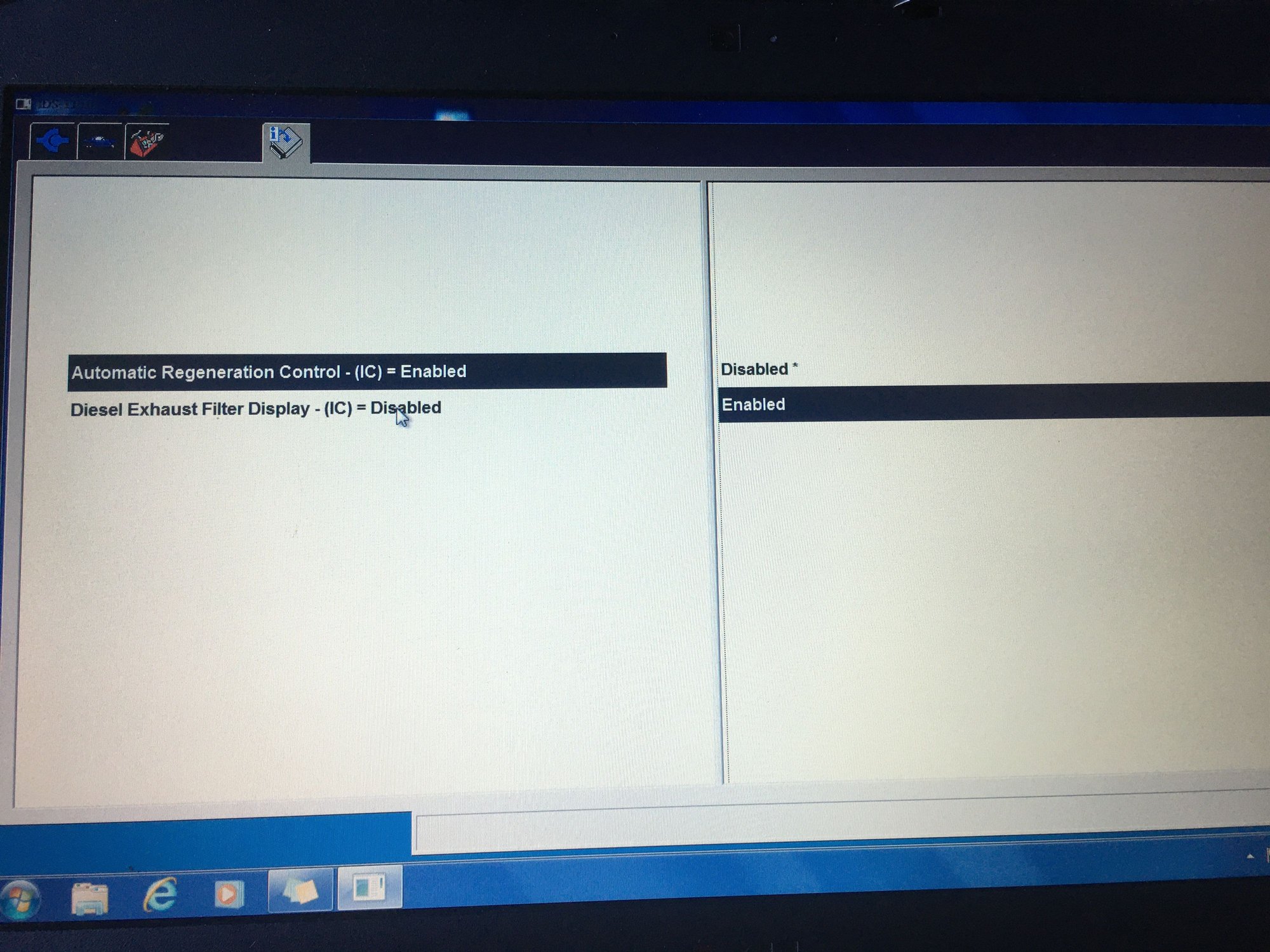

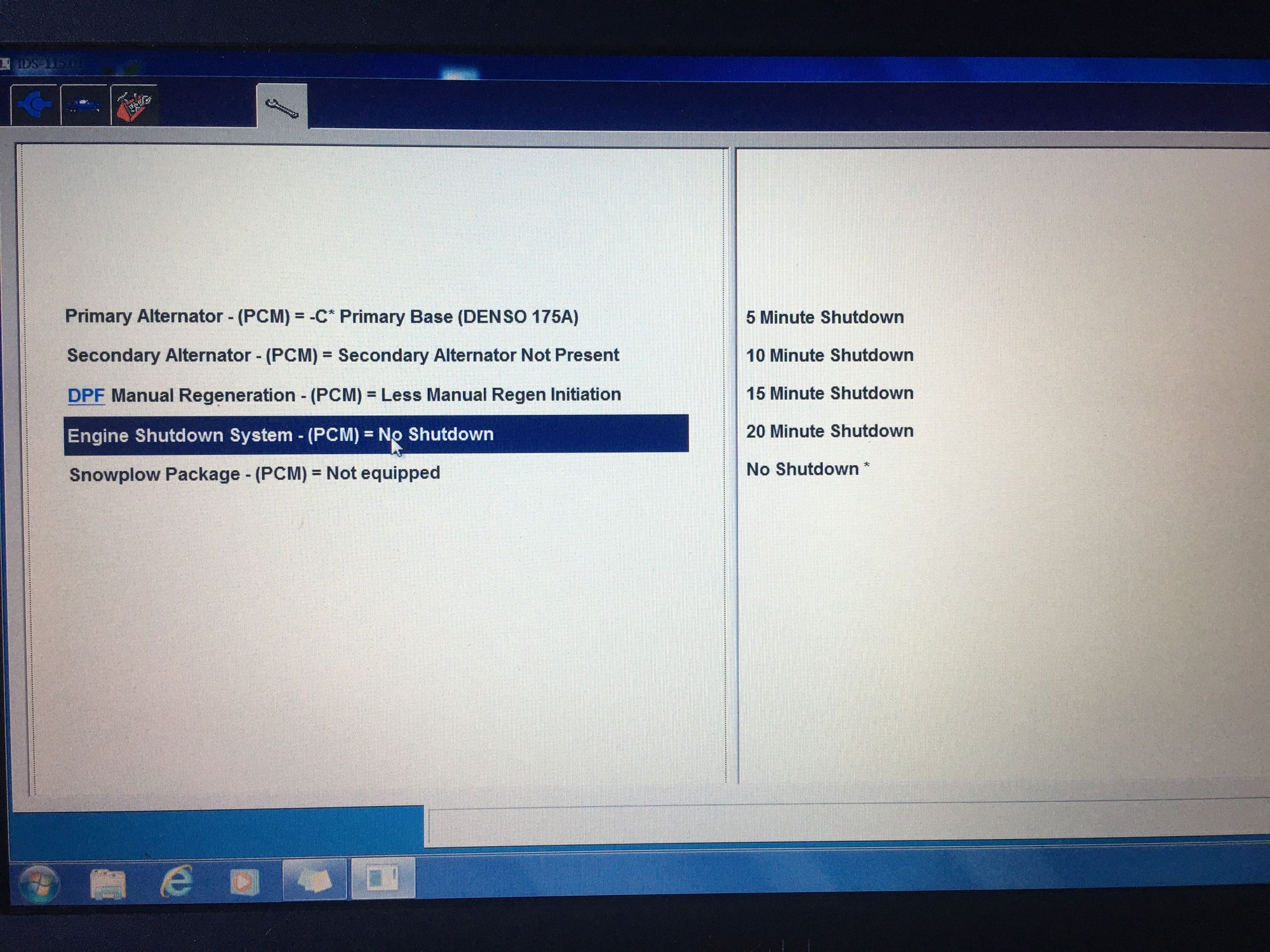

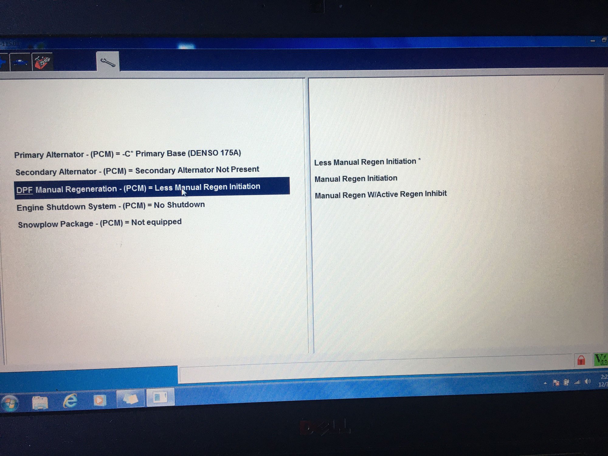

Just had my remote start installed today. I went to a local mechanic shop who has the Ford IDS software. Charged me $50 and took US about an hour...... Yes, US an hour! Well, the guy said he's never done one before so it was a learning curve for both of us as I helped him lol.
Anyways, we finally did it and the remote start does work. After getting home and re reading the instructions in the manual, I noticed that a lot of what was supposed to take place didn't during the programming didn't. IE open door, close door, turn key to on and off XXX of times etc etc. Not sure if this means the remote start is half as sed installed or if I am good to go.

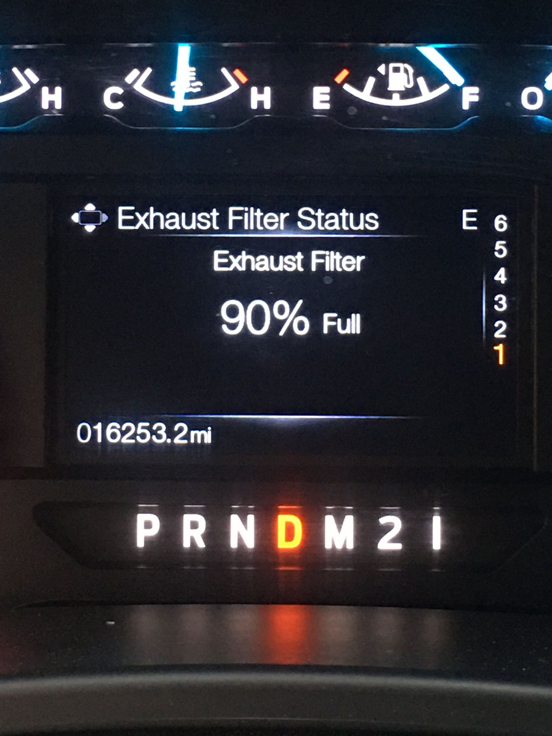

Since the guy was cool, I wanted a few things enabled while the IDS was hooked up. There were a few features that neither him or I knew anything about. So I figured Id ask here. In regards to these pics, what exactly do they mean? Is this to enable a operator Regen? I now have the screen the shows what % my exhaust filter is clogged at, which is cool.
