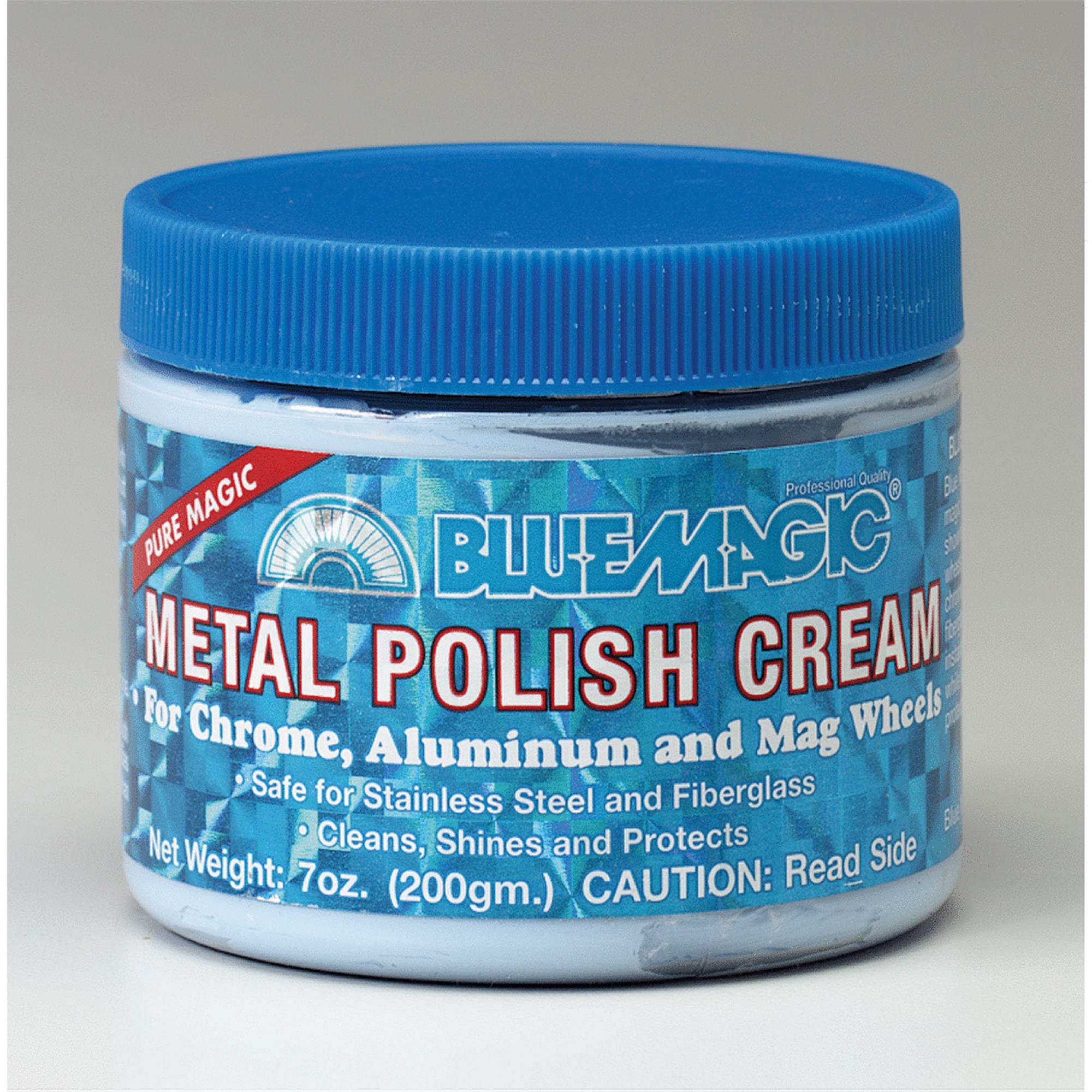

Believe it or not, this stuff you can buy at Walmart called Blue Magic works great on plastic also. It will not get deep scratches out of the speedo lense, but once you clean it, and then you end up with all those spider web looking scratches in it, this stuff takes it right out. It's made for metal but works well for the cluster I have used it several times. I also have used it for hazy plastic headlights.
Thanks for making us aware of that stuff and the fact that it will polish plastic.
Everything I own and drive has real glass lights; in fact, I often refuse trucking jobs when the truck has those stupid plastic lights; however, the wife insists on driving this piece of crap little toodle-around car that does have those plastic lights and her's are so badly hazed over that you have to get close and strike a match to tell if they are lit.
I may feel benevolent and see if I can polish the lenses, although it goes against my grain to waste time on such disposable vehicles.
