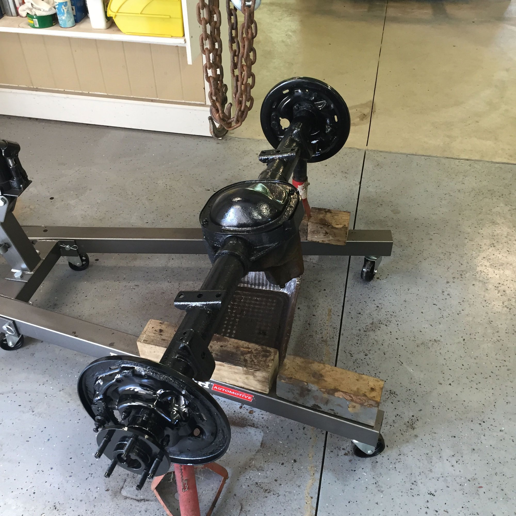

I have a 1950 F2 and I agree that the F1 & F2 front axles are the same and that the best way to get 5 lug front hubs is by going to disc brakes. I got mine from Speedway motors:
Front Disc Brake kits at Speedway Motors
You should also go with a dual chamber master cylinder for safety. Here there are a few things to consider:
  1. Are you going with disc brakes in the rear or drum? The master cylinders come disc/drum or disc/disc with the difference being in the built in pressure relief valve(s). You have to choose the right one but if you change your mind there are external valves that you can add.
  2. Are you going to use the factory pedals in which case you will need an underfloor kit AND a remote fill kit. This was tricky when I did it because only F1 kits were available. But with just a few minor changes I made the CPP kit fit just fine. Here is the link to the thread that I created on how I did it (with pictures) https://www.ford-trucks.com/forums/1...-48-52-f2.html. Make sure that the remote fill reservoir is translucent so you can easily see the fluid level. Price is not any indicator of usefulness. This is the one that I used from Summit Racing: https://www.summitracing.com/parts/clp-rrck/
  3. If you decide that you want to use hanging pedals then you will need to reinforce the firewall or cracks will eventually develop. This of course also takes up space in the engine compartment. But it doesn't need a remote fill.
  4. There is now a third alternative which is electronic booster with master cylinder. See https://www.speedwaymotors.com/Compa...Disc,8335.html. It is a bit pricey and probably requires hanging pedals. I don't know anything about how these are installed. Maybe somebody here knows. They would require a switch to a 12v power which isn't a big deal but is added cost. The race car crowd like them as they are light weight and require less space.
As for rear axle I went with a rear axle from a 2001 Ford Explorer Sportrac. The width was correct but I had to cut off the spring perches and re-weld at the correct location on the other side of the axle. Be sure to check your pinion angle before rewelding,
Hope this helps. Here are a few pictures:

Wow...that's a big pile of rust off of your rear axel!...... good thing you have a bucket on your loader!...
