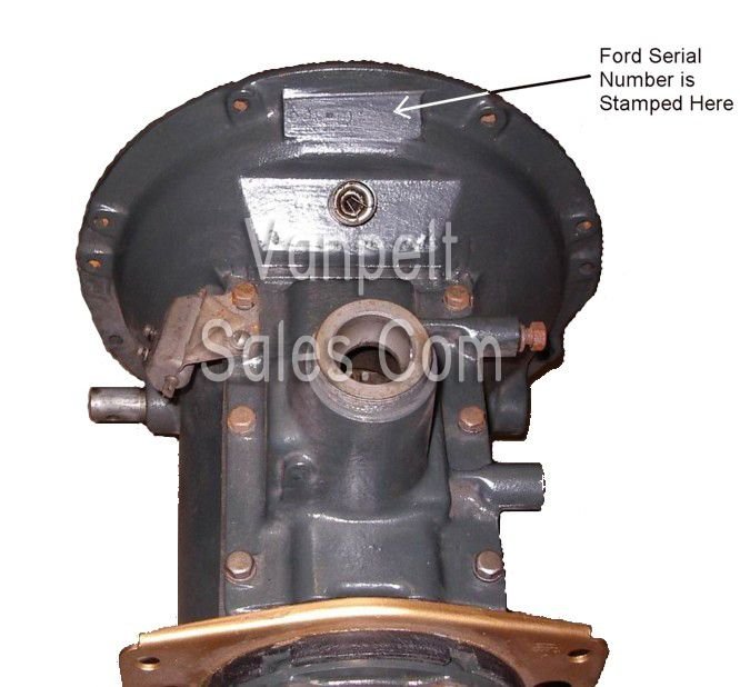

Where did you find this number, on the engine block? There were no VIN's back then, vehicles were registered by their specific engine number.
On Ford's, the engine number was also stamped on the hogshead.

Thanx ND, the number was from the title. When I get home tonight I'll ask him if I can take a look at the engine. And just so I don't look to goofy, where's the hogshead?

Top of transmission 1/2-bellhousing, just behind the half of the bellhousing that is part of the block. Probably not easy to see with the engine installed (and covered with crud).

Ford also stamped the serial number on the frame, too. It's typically found on the left side frame rail near the steering box. Back then, the title/registration always referred to the engine number, but way too often the engines were swapped out with rebuilt or remanufactured engines, and the correct engine with the registration number was lost. It made it difficult to identify vehicles by the engine number when the engine had been replaced. That's why Ford stamped the engine number on the frame and transmission instead.
