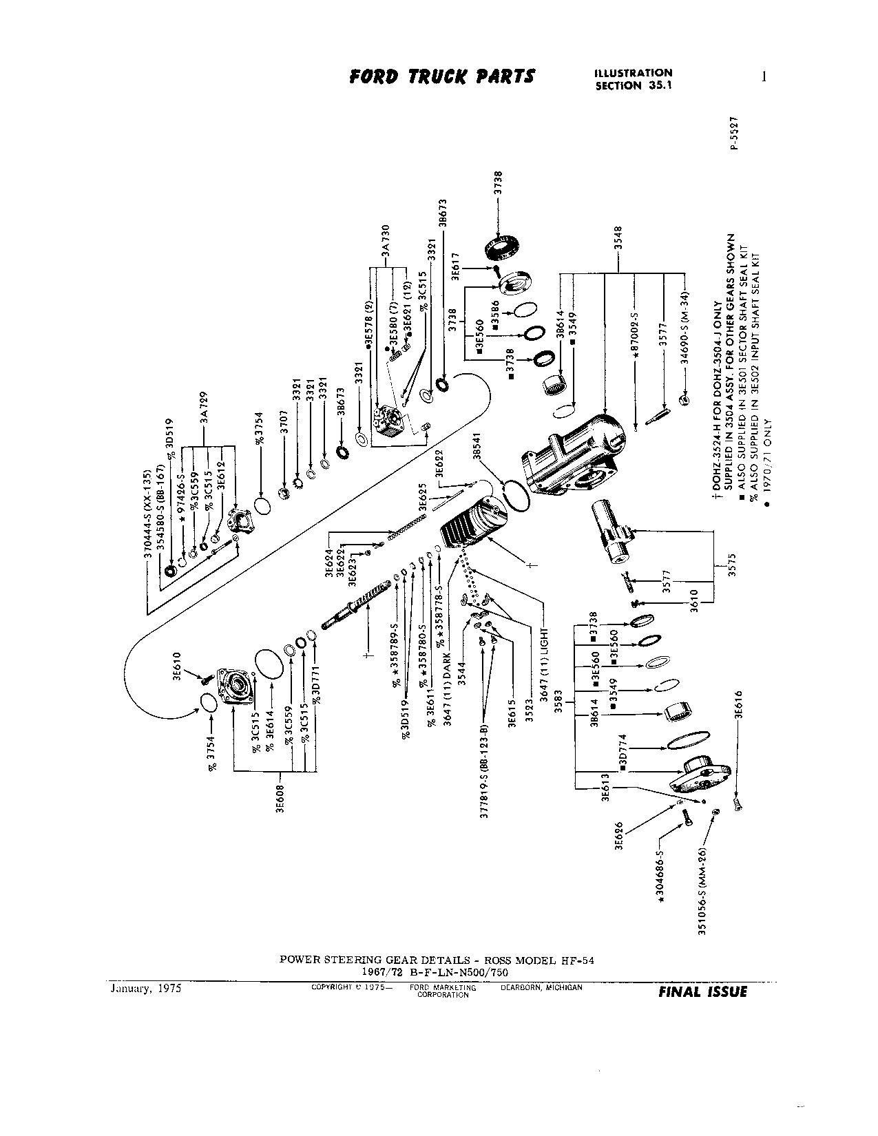

Here's the Ross P/S gearbox:

Thanks for the parts break down. Thats a great help. I'm working on locating a seal kit now. The rebuild options are a little pricey.

If the P/S gearbox I posted a pic of...is the same as yours...
C7TZ-3E501-A .. Sector Shaft Seal Kit / Obsolete
HAVEN FORD PARTS in Haven KS has 1 = 520-465-2252.
CARPENTER NOS OBSOLETE PARTS in Concord NC has 19 = 800-476-9653.
GREEN SALES CO. in Cincinnati OH has 23 = 800-543-4959.
C7TZ-3E502-A .. Input Shaft Seal Kit / Obsolete
GREEN SALES CO. has 1.
KLIMESH MOTOR SALES in Calmar IA has 7 = 563-562-3241.
CARPENTER NOS OBSOLETE PARTS has 12.
