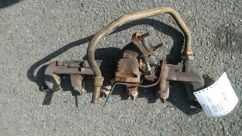

The photo is upside down, but the O2 sensor can be seen underneath the exhaust flange... it looks a little like a spark plug.

Thanks for that pic. Is that an 83 manifold? And if I have one on my mine, how likely is a faulty O2 sensor to create mild surging while driving? I imagine it's a bugger to swap out after all these years. Prolly heat welded in place.

I think it is pretty unlikely that your Canadian market truck was built to California specs, thus no O2 sensor. FWIW, I have an 83 parts truck with the 300 six and no O2 sensor.
As to mild surging, I would be looking for vacuum leaks.
