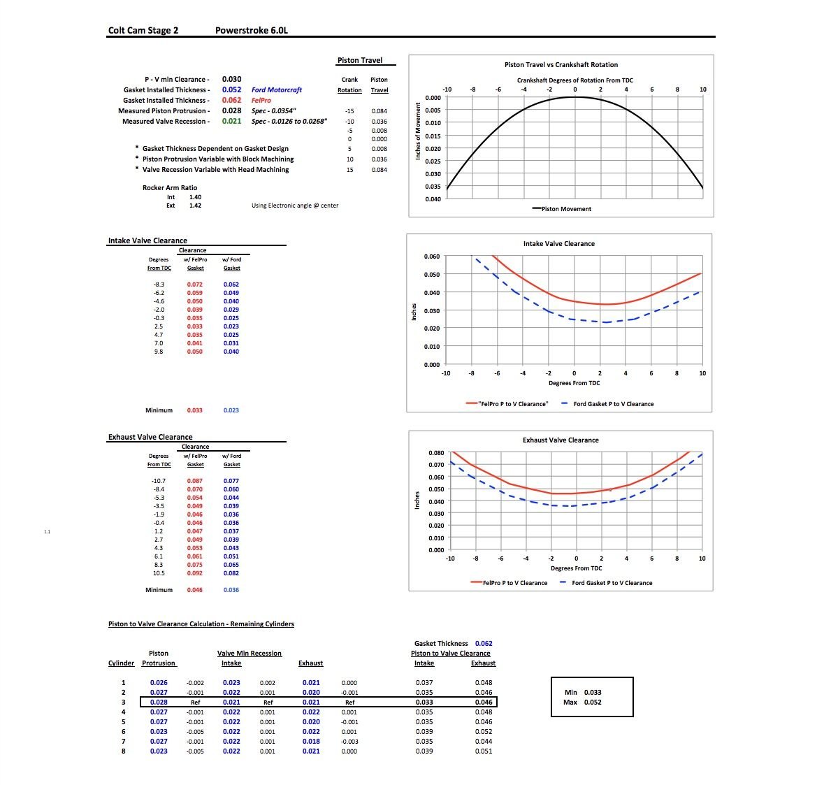

For me, I would have gone with a Stage 1 cam, but at the time they were all reground. With the Stage 2 cam that I got, I've checked the piston to valve clearance and I'm nervous about that. Geoff said 0.030" one time and 0.035" the other. I was asking how much piston protrusion and how much valve recession, but he wouldn't bite. For this application with a locked gear drive, those values should be given by the grinder. While doing the checking is when I got frustrated about the crankshaft grind, so swapped the crank, something I would rather not have had to do. At the time I asked David if he could get me his motor's numbers while he had it apart, and he went out of his way to do that. I also wne to another site and got a rebuilders data, but they build to a 0.025" piston protrusion. Out spec is 0.035", normal production seems to be 0.032"
So I made a reference chart for target numbers for the Colt S2..... back in the spring.
Today, KDD and DD does what I was asking for, tells you the piston protrusion and valve recession you need. If you understand how OCD I get, I wanted a hard number from Colt. I'll be releasing a video about doing that work, you'll be well finished based on my speed of production. For my driving, today I would be buying Stage 1 since they now do billet, I don't do high rpm. And don't think it hasn't crossed my mind to yank it apart a third time .....
