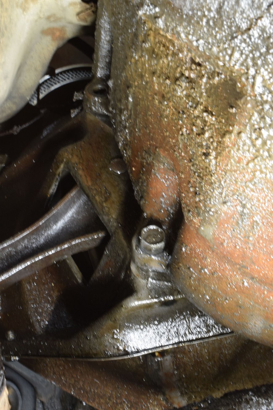

Well, for better or for worse I found what has to be part of the problem. The transmission only has 2 bolts holding it in! And they are half backed out. I couldn't get any pictures of the other side, but its in the same condition. As you can see it's leaking oil like crazy. I went to the top side and took a video of all the slop. Everything in there is wiggling all over the place.
So, now throwing this into the mix, what all could have gotten trashed while driving around like this? Input shaft? Something on the bellhousing/motor side?
No idea how long the previous owner drove it like this. I did a quick 2 mile test drive before deciding there was definitely a real problem.

In case anyone happens across this in the future because they are having a same or similar issue, the tranny being run not properly bolted up trashed things to the point where it will cost quadruple in hard parts than just buying a used one locally.
Heres a video of the slop in the input shaft and the resulting damage to the input gear and the gear below it. There was also damage to 1st gear which just added insult to injury. I don't believe it was related, but rather just 45 years of grind em till you find em.
I already have the rebuild kit, so I'll find a used one and rebuild it and hopefully get another 45 years. Thanks all for the help
