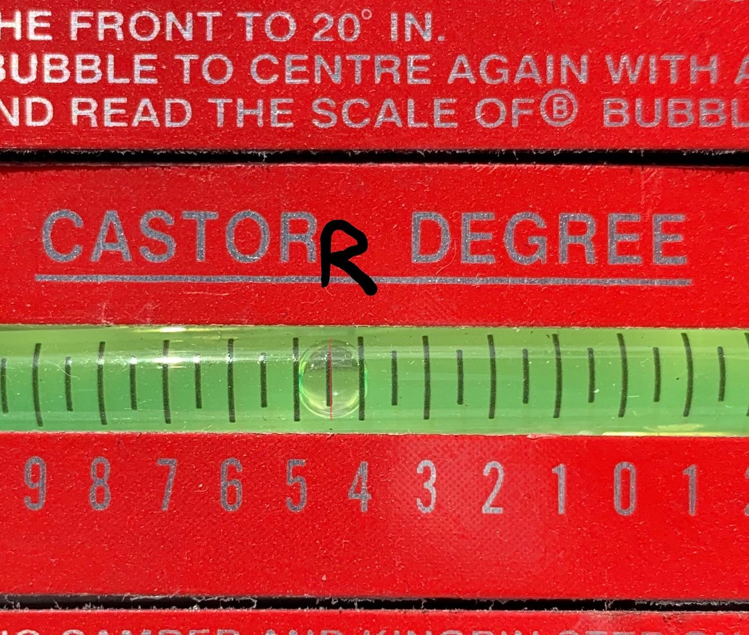

the shop should have given you a printout of your alignment specs. This is my factory caster setting that rides excellent.
adjusting caster post lift requires shims that are easily purchased, but would not typically be on hand at a shop.

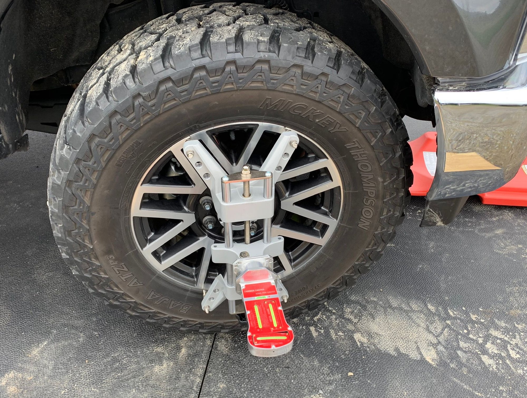

Going a little heavier on caster (into the low 5s) won’t hurt anything. The 2.5” should work fine. I suspect your 1.5” lift is a little bigger than you think anyway based on the wheel being off center...
