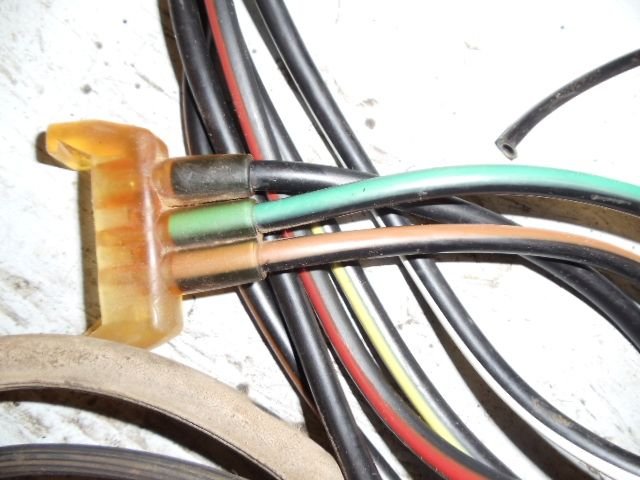

The purpose of the heater bypass valve is to cut water flow to the heater core when the A/C is switched on, for obvious reasons. I believe the vacuum line goes behind the dash and into the HVAC control which, sends manifold vacuum to the bypass valve when A/C is selected.

I believe this is where it enters the cab through the firewall on my 73 390 with factory AC. This is near the brake booster.

Behind the HVAC control on the dash you'll find two vacuum line manifold plugs that plug into the control. One has 7 vacuum lines, the other has three, These are all color coded. The one that goes to the hot water cut off valve has a brown stripe and goes to the plug that has three vacuum lines.
