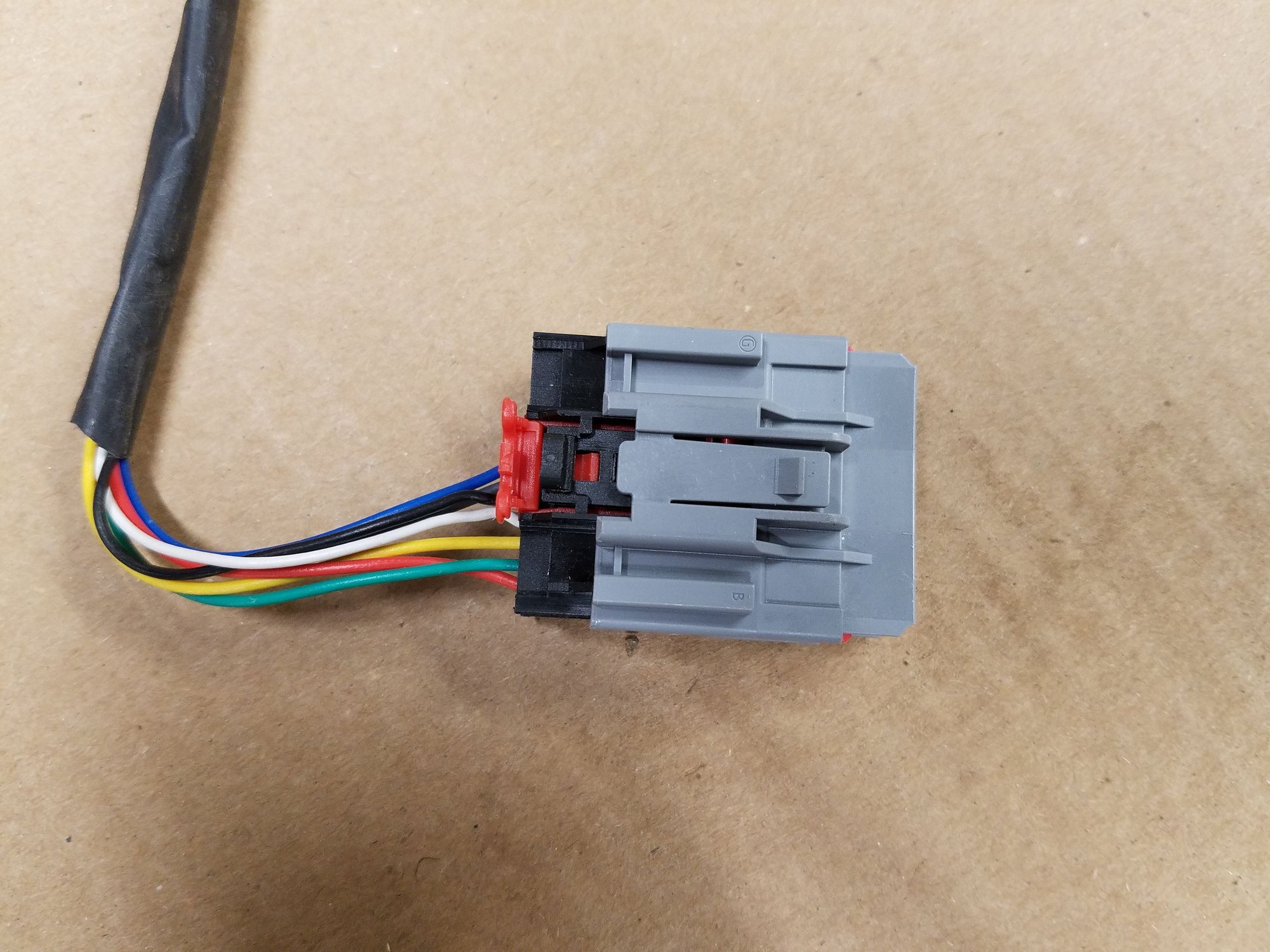

UPS delivered ...the shells I ordered fit the 22 cavity mirror connector and lock.
The Mouser p/n for the connector is 571-2-1419158-8...they are about $3/ea. I ordered 2.
for the pin is 571-2-1419158-5-LP...they are like .20/each, I ordered 22. (less than 10 per side is required)
You will be cutting off your old 4 pin or 8 pin connector and re-pin this new shell to match the mirror connector functions.
