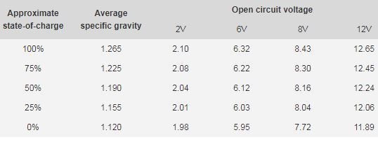

12.7 volts is pretty much fully charged on a lead acid battery, I doubt you'll see higher than that except for a short time just after removing the charger (surface charge which gives a false state of charge reading). Charging voltage is another story, should be about 14.1, but open circuit voltage is more like 12.7 (see chart, last column.
