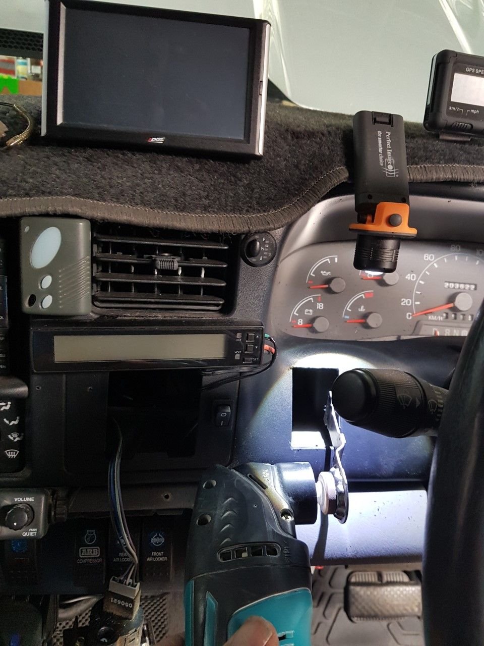

Hydra Installed
Hydra Installed ,
After coming back from pulling my Lobster Pots (got a feed) I checked my Post Box:
Stirling service from Riffraff, my Hydra with 1023 Tunes had arrived.
So after cooking the Southern Rock Lobsters, I set about installing the Hydra.
As the truck is predominantly a tug I got mostly the Tow Tunes:
Tune 1: Daily Light
Tune 2: Heavy Tow
Tune 3: Medium Tow
Tune 4: Light Tow
Tune 5: Daily Econ
Tune 6: Street Shredder
No issues installing at all and took her on an extensive run around the same route with varying terrain using a different tune each lap.
Very impressed with the performance. Will see how she goes under tow next.
Cutting hole in dash to fit Hydra Switch
Hydra Switch Fitted
Hydra Switch Fitted and KOER.
