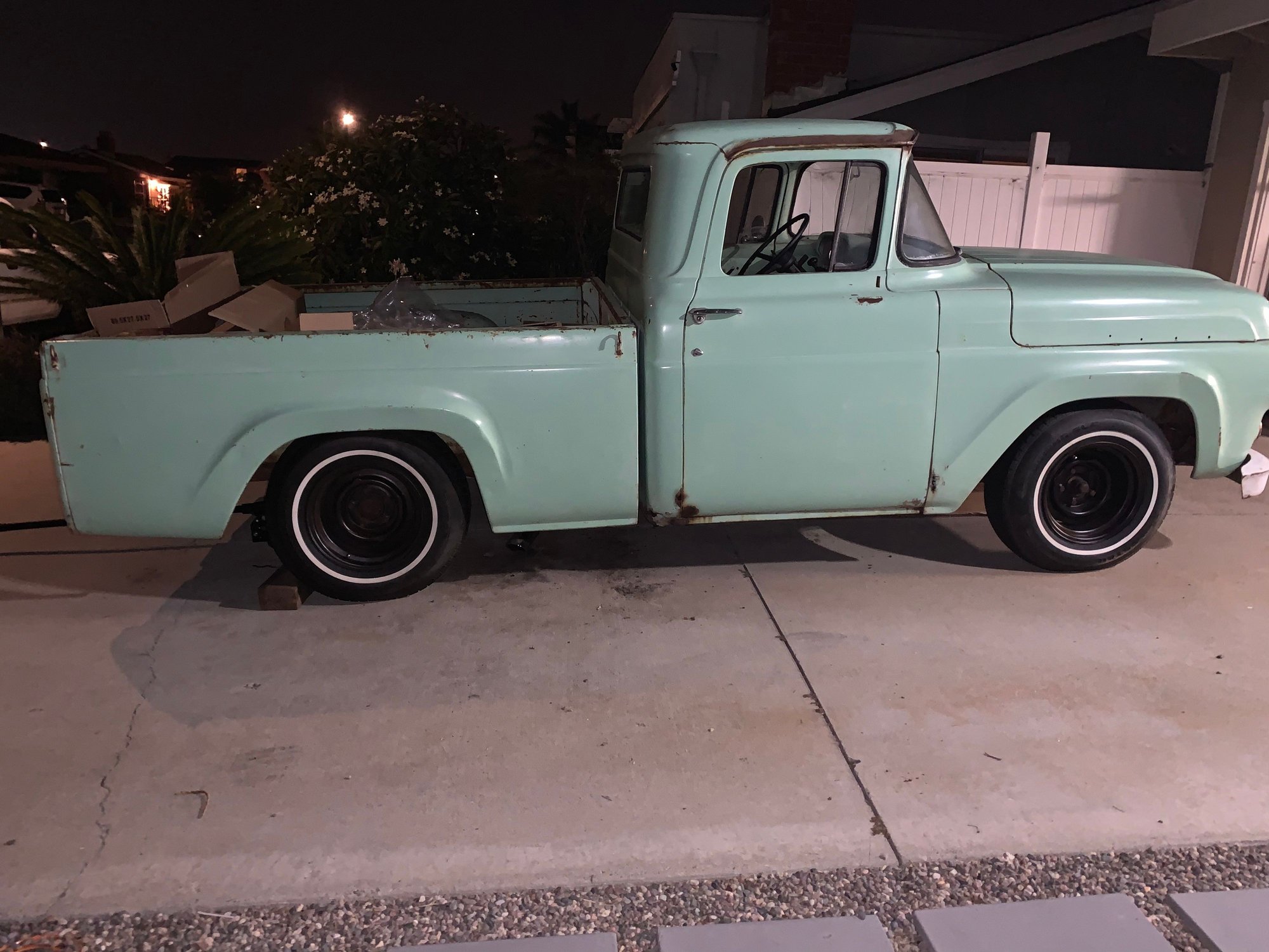

Old Jul 1, 2020 | 01:02 PM
bjano00's Avatar
bjano00
Joined: Feb 2019
Posts: 44
In this pic I just removed a few leafs out of the front leaf packs. I think it lowered about 4-5 inches from stock. I’m in the process of installing a new mustang ii though
